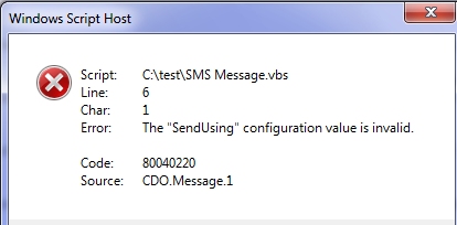

I tried running the script on my computer (Win7), but I am getting an error message
Does the script utilise an existing email application that has to be open? (I am currently using Windows Live mail)
