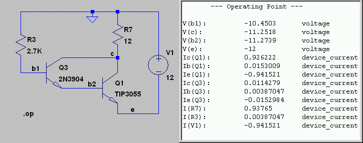

Simple Solar Tracking circuit

Since you seem to think that a base resistor is needed in this circuit, please explain the plot shown below:
Why is the base current of Q1 Ib(Q1) equal to only ~380uA without a base resistor when the transistor is delivering 92mA to the load. Note that the emitter current is determined by R1, and that maxes out when V(R1) is 10V - Vbe.
solarseeker-png.42242
This is the circuit I am talking about and there is no current limiting on the output of U2.
How does U2 (an LM339) drive an NPN transistor without a pull-up resistor?
As the emitter of Q1 is at -12 volts then R3 connected to zero volts will be a pull up resistor as the base of Q3 does not need to be driven more positive than about - 10.5 volts.

Oh, thanks. I didn't pay any attention to the negative power supply. There is a 2k7 pull-up resistor.

U2 has an open-collector output. It needs a pullup to drive the base of the NPN transistor; that is the function of the 2k7 resistor.
Connecting the collector of the first transistor in the super-alpha arrangement to the collector of the output transistor means the output transistor cannot turn ON fully.
If we take Q3, it cannot behave as an amplifier if the collector is not at least 0.3v above the emitter.
If the collector voltage is less than 0.3v, the transistor simply acts to pass the base current to the emitter via the natural voltage drop of this junction.
With the collector 0.3v above the emitter, the minimum voltage on the collector will be 0.3v plus 0.7v across the base-emitter of the TIP3055. This means the collector of the TIP cannot go lower than 1v.
Connecting the collector of the first transistor in the super-alpha arrangement to the collector of the output transistor means the output transistor cannot turn ON fully...
You have accurately described the well-known limitations of the Darlington connection, where Vce(on) =~1V.
So What! The power dissipated in Q3/Q1 is less than 1W, it switches >1A to a 12V motor with about 4mA into the base of Q3 and if the neg power supply is -12.0V, the motor still gets more than 11V across it.
If you really, really wanted a more efficient switch then use an NFET instead of the Darlington. The original goal of the this design was easy availability of the parts, so I tried to use what in 2010 might have been available in a RadioShack, which has since closed most of its stores...

Tony, Q1 ('3055) is not saturated, so your analysis doesn't work. The base current of Q3 doesn't depend on the comparitor at all! R3=2.7K, not 4.7K. I have no idea where you pulled a LM358 from?
Look at the predicted voltages/currents in this simplified circuit with the motor switch on.
Note V(c)-V(e)=~0.75V.
Note the current in R3 = ~4mA
Note that Q1 would be dissipating only about 3/4W.
This sim was done with the nominal β for both Q3(300) and Q1(360). I reduced β to 50 for both Q3 and Q1 and the voltages/currents changed hardly at all.

A 3055 with 0.7V Vce @ 1A is nowhere close to being saturated, and its β is still whatever β was. To get a single, non-Darlington connected NPN power transistor to saturate (so that Vce is as low as possible, typically about 0.4V, you overdrive the base with a base current of Ic/10, not because the β=10, but as a safety factor to minimize Vce and power dissipation in the transistor, especially at elevated temperatures.
An advantage of the Darlington connection is that you do not have to (nor can you) overdrive the output transistor or get it into deep saturation. None of the base drive = Ic/10 stuff applies to driving a Darlington. Go look at an integrated Darlington data sheet.
For example, look at Fig 2 of the TIP120 data sheet. It shows that to get a Vce of 0.6V at Ic=1A, the required base current is 4mA.
The integrated Darlington here uses a ratio of 15 per stage instead of 10 so they get 250 for 2 stages. I used 10 per stage or 100 per pair.
