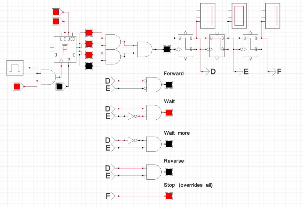

just to clarify the objective:
device is placed at the starting zone
device is triggered by a single physical motion (flick a switch, whatever)
device drives forward (approx 2m)
device stops and waits while it receives payload
device drives back to start
device stops
and thats it.. pretty simple really, i need to decide whether to time the whole thing in timed stages, or time the drive and then start the drive back when the payload is transferred..
i used CEDAR logic simulator to design a simple circuit using a 4 bit binary counter, 3 D flip-flops and a bunch of AND gates (see attachment)
im planning to use a 74LS161 4-bit binary counter and a 4076 quad D flip-flop IC. If it isn't clear how the circuit works, basically each time the counter counts a cycle, it changes the state of the D-flip flops, and then i used logic gates to determine the action that is desired..
basically, it goes forward for 16 counts, stops for 32, and reverses for another 16 and then stops completely..
is this a good way of doing it? or have i overcomplicated the situation?
then i need to use the logic to actually trigger the h-bridge itself..

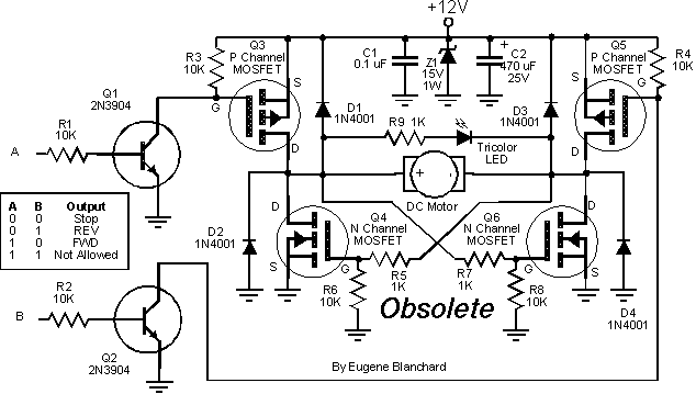

ive had a look on the internet, and one of simplest circuits i could find is this one (see attached) that i took from (The Using MOSFETS Website: H-bridge using P and N channel FETs).
would this be suitable for my purposes?
would mosfets IRF9540N and IRF1405 be good to use? also, i am not entirely sure about the difference between mosfets and just standard fets.. would it be ok to use a standard N and P FET in this circuit as opposed to the more costly mosfet?

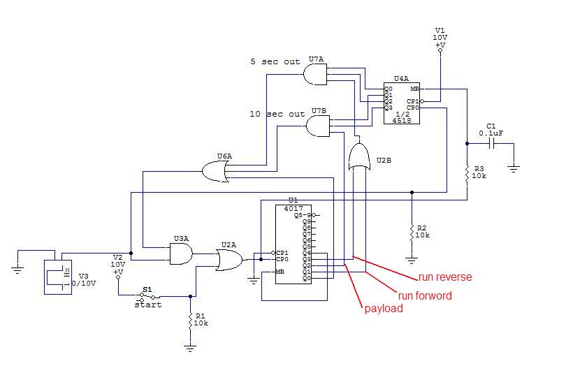

what i understand is you feel its enough to control it by time, not using sensors, in real life sensors are the right options. any how i considered as you said to have 5sec forword then delay for 10sec and again 5sec reverse operation, see the attached one, i have shown only the controller part, the particular outputs can be wired to H-bridge to control.
i tried to simulate, but in digital mode it refused to do it with cap, without cap its not showing corect reset.
hope you will understand how it works.
Edit: U2A is an AND gate, mistakenly i put OR, but stil it works.

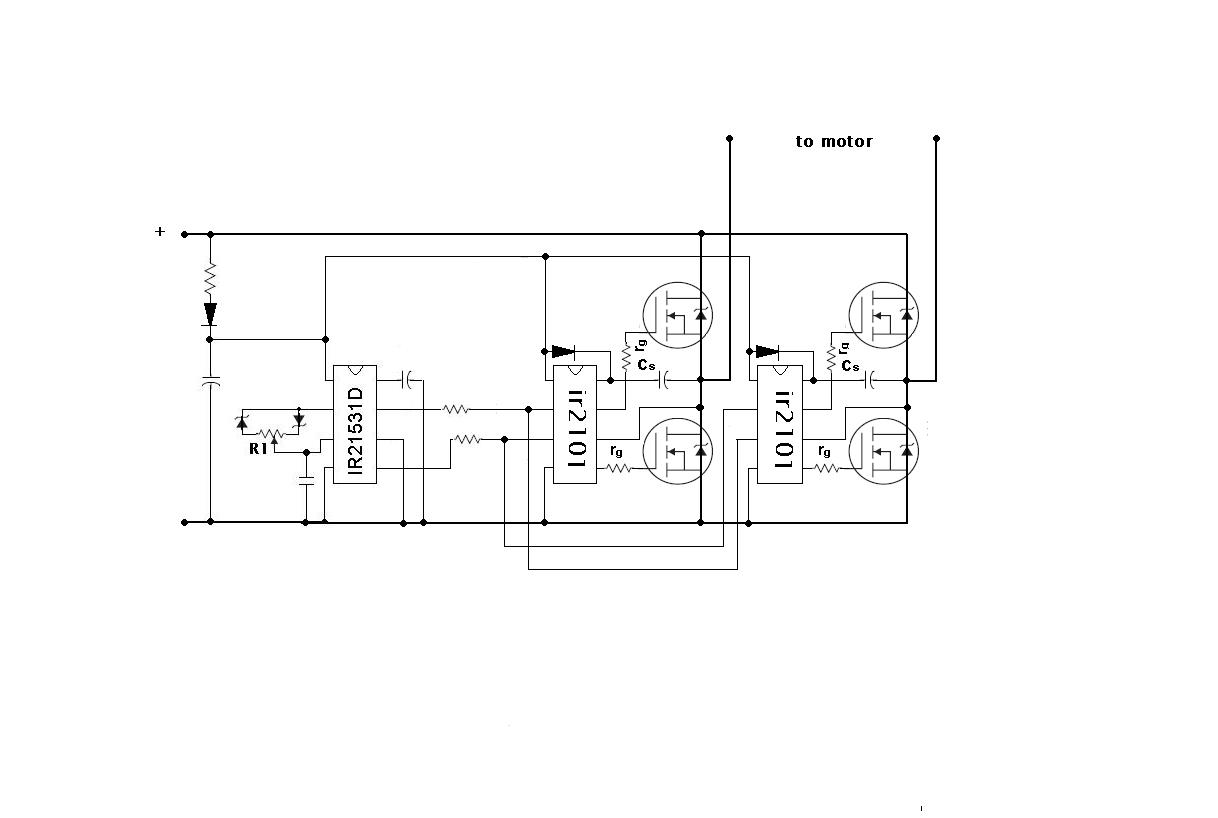

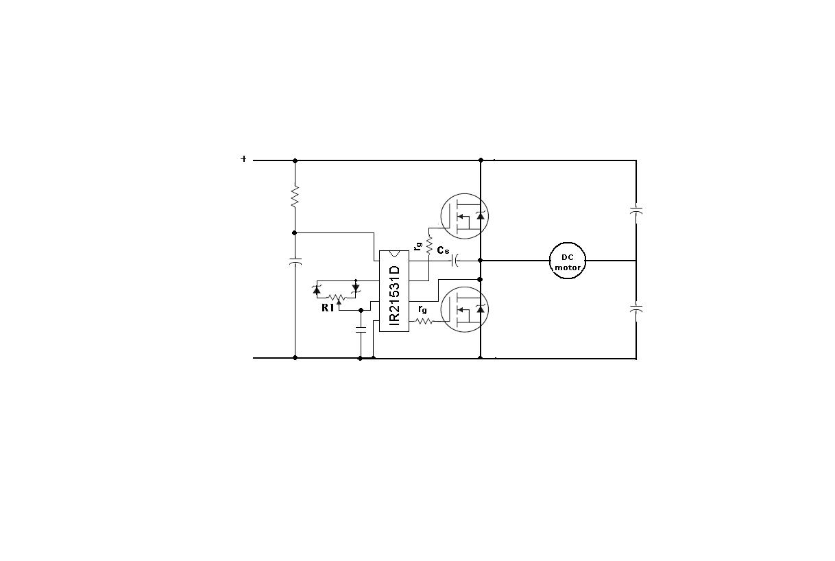

2phcompleteparal&#10.JPGI belive this scheme is the best solution to your needs. The time's period is regulatable by resistor R1. Periods of turning (of on) are interrelated each other.
Those capacitors would have to be huge do drive the motor at a low enough frequency to be usable.
It's also a good idea to stop a motor before reversing it, otherwise it may overheat and will certainly overheat if it's left oscillating for too long.
Dvinchy
this particular IC is for different application, not to make timing for motors. this is for high frequency switching and as Hero999 told, it needs a very large capacitor,the OP need a delay for load for the object. hope you didnt understand his requirement. i have slightly improve the schematic i have pasted before, also there is a flaxibility to use dip switches to set the required time delay by some more additional parts.
Although the full bridge is much better than capacitors above.
That's better, with the full bridge you get the full supply voltage, with the half bridge the supply voltage was divided by half.
As mentioned above, this isn't the right way of doing it: the motor will smoke if it's reversed too frequently without being stopped first.
Reversing a motor when it's at full speed will produce nearly double the stall current at the point of being reversed, causing currents as high as a couple of hundred Amps, even for a modest sized motor. If the motor doesn't blow, then the semiconductors certainly will.

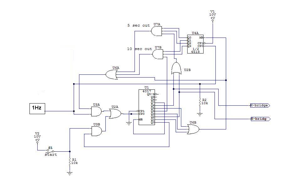

see the attached with some changes, i simulated and its workign fine, dip switches can be added at the stage of 5 sec and 10 sec timer so that time can be set upto 32 sec for both.
hope it will full fill his requirement without a PIC, and using available ICs at local market.
Edit: use binary counter 4520 or any other (4518 only counts upto10)
