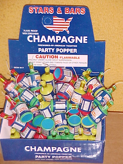

I tried those piezo sparkers and they were unreliable for me. Worked 1 in 10 times.
I even made a coild driver and that was unreliable too.
Worked once in 10 times.
I gave up on those two, and went for the ROCKET IGNITER/ELECTRIC MATCH.
100% reliable.
Hey, No batteries required.
Try these little beauties.
Just pull the string and BANG!

Good idea, I know piezos can be unrelianble but the coil driver shouldnt't be, it sounds like you used crappy cable and not the proper HT stuff.
LOL,
[start of a story]
...OK Johnny, you hold the potato cannon while I go up front and pull the cord...
Breaking news story, potato cannons gone wrong...
[end story]
I cant see that being any good at all LMAO
but really, those things are fun but also expensive where i get them locally
