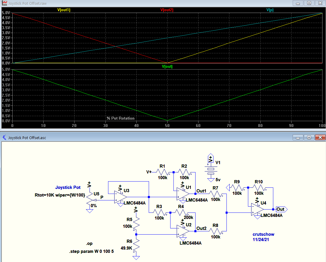

Below is the LTspice simulation of a circuit that, I think, does what you want:
It uses one quad rail-rail op amp package, along with a bunch of resistors to generate the desired function.
Note that the output green trace) goes from 5V at the 0% pot position (horizontal axis) to 0V at the 50% position, then back to 5V at the 100% pot position.
The blue trace is the pot output voltage versus pot wiper position, the red trace is the output of op amp U2, and the yellow trace is the output of U1.
The output of U1 and U2 are summed together by U4 to give the desired output.
The output is ratiometric so will track any variation in the supply voltage with zero out always occurring at the 50% point of the pot.
All resistors are ±1% type.

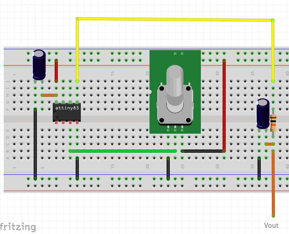

Of course you could do this in 8 pin micro with internal ADC and (DAC or PWM).

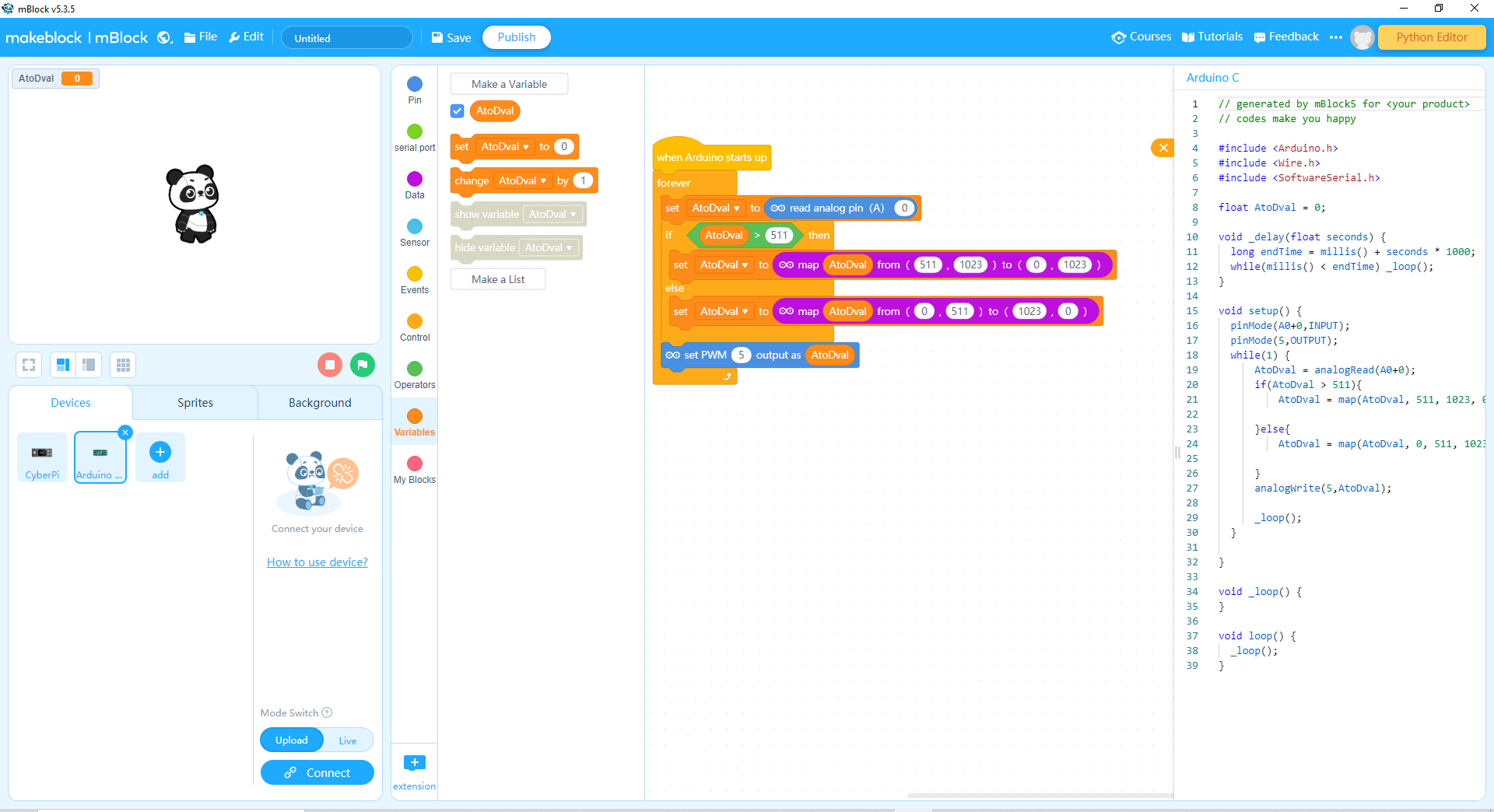

I think this would work -
The code blocks user sets up, as shown, are converted to Arduino code as shown in right hand window, by mblock.
Would take the ATTINY85 + 2 caps, one for ATTINY85 Vdd pin, one for PWM filter) and a resistor for PWM filter.
iu
Regards, Dana
Note that the output (blue trace) goes from 5V at the 0% pot position (0.0 on the horizontal axis) to 0V at the 50% position, then back to 5V at the 100% pot position.
The yellow trace is the pot output voltage versus pot wiper position, the green trace is the output of op amp U2, and the red trace is the output of U1.
I really like this one as it solves another problem i had with interchanging the signal common when motor polarity reversed. This will provide on continuous signal over the motion of the Stick
I was not even aware of the 6484, will order some & test. Looks like the R-R operation is necessary to pull this off... I have alot of older stuff like TL084, LM308. etc but i don't suppose it is even worth a try with those (?)
Thx
Bob

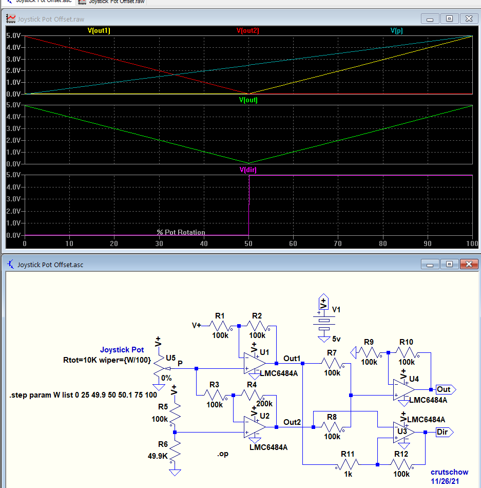

You also need a V+/2 comparator for direction with >1% hysteresis
The output shud control current, not Vavg of PWM using amplified 50mV shunt for Imax in a servo loop. Or else control Vavg with a conservative 3x Imax current limit loop.
A better option would be a comparator connected between the internal Out1 & Out2 points in Crutschow's circuit, as the forward / reverse changeover will then track the zero speed point on the pot accurately, even if it's not a perfect mechanical centre point.
Below is the simulation using one of the four op amps to generate a direction output comparator signal (Dir, purple trace) as suggested by rjenkinsgb:
It should eliminate the need for the photo-interrupter circuits.
If you want the opposite polarity for the Dir signal, just reverse the inputs from Out1 and Out2 to the comparator.
