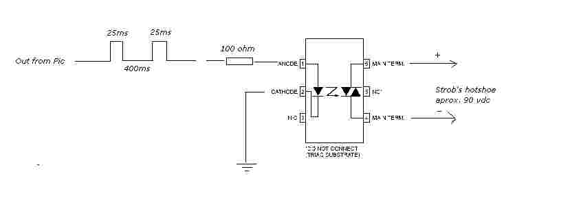

I need to have a Camera's Strobe Flash 2 rapid times aprox. 400 mill seconds apart. Im using a Pic micro for the delay, and a OPTo triac ( MOC 3020 ) for the switch. If I understand right a Traic will not shut off untill the current is removed so the flash Cap will be to low for a second flash.
Any suggestions for turning off the Triac?

I'm Not trying to design a new strobe circuit. What I'm trying to do is trigger a strobe to flash twice withend 400 ms.

The MOC301XM and MOC302XM series are optically isolated triac driver devices. These devices contain a GaAs infrared
emitting diode and a light activated silicon bilateral switch, which functions like a triac
https://www.fairchildsemi.com/ds/MO/MOC3020-M.pdf
so its not really a triac ..its a bilateral switch..designed to drive a triac..
This optoisolator should not be used to drive a load directly.
It is intended to be a trigger device only.
Well, you are right about the triac problem. I don't see any way you could commutate it. You'd need a high voltage bipolar or a really HV MOSFET (MOSFETs this high are a bit rare). It needs to be able to handle an amp or so of surge current too.
