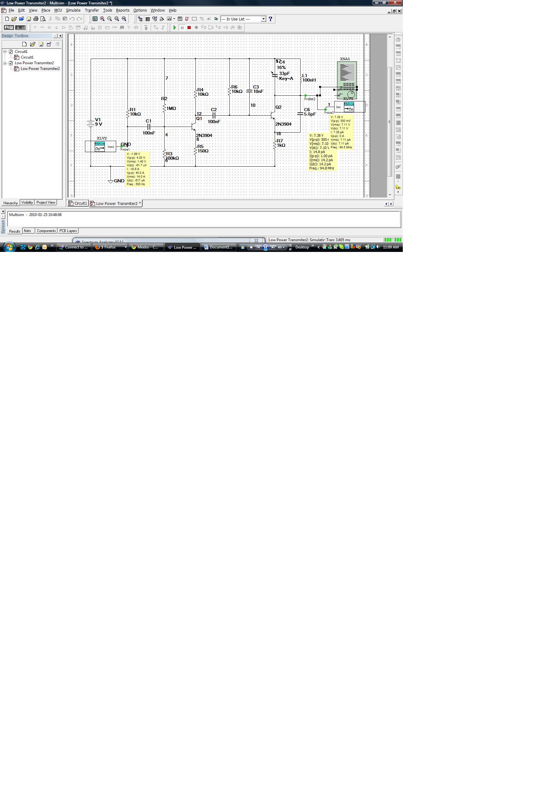

Dear Friends,
I need an asistance in making my project of FM Transmitter to work.. Can someone help me out here, as i need to make it work in 2 weeks time.
I have actually made some effort and come up with an output signal but needs to verify if i am on the right track. I am not even seeing the actual modulated signal..
Moreover, the frequency deviation is more than the normal standard deviation for FM signal.
Another problem is my carreer frequency.... When i calculated the theoretical values and compared to my actual value from my simulation in my tank circuit. it was totally different
Thank you for your anticipated help

Can you turn off the dots that are all over your schematic?
Your microphone signal is 4V p-p which is nearly 800 times too high. Turn down the level. It is saturating and cutting off the oscillator transistor which might change its frequency.
Stray capacitance of the parts and their wires nearly double the amount of total capacitance in this very high frequency circuit that your calculations do not account for so of course the actual frequency is much lower than calculated. It won't work if you make it on a breadboard, a compact pcb or stripboard must be used.

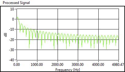

Thank for you time...
I have cut down the peak to peak voltage of my microphone...to 80mv..
Below you will find the modulating signal..
Are you saying that my electrical connections affects my capicitance so i could not get the actual caculated frequency. How could i solve this problem... I am not actually constructing this circuit... I was required to verify (frequency deviation.... and others..) and simulate the circuit with the aim of arriving at a desired modulated signal.
22% of 33pf as in my tank circuit.... does not actually gives the actuall capacitor value... is it actually 22% of the variable capacitors value...?
