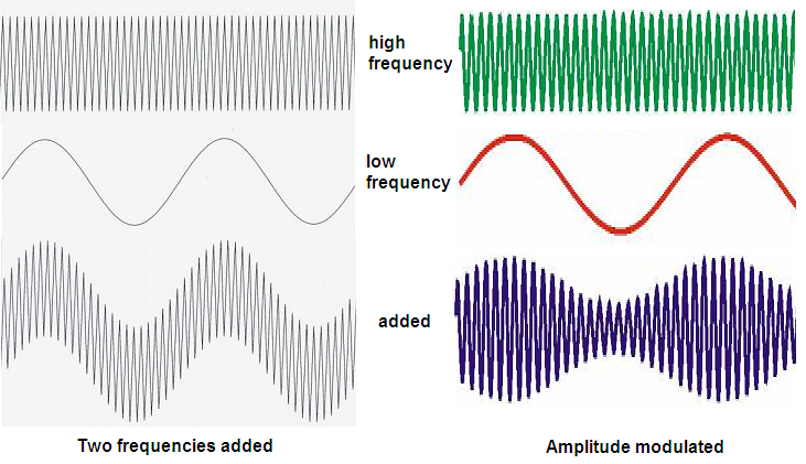

That's what I wanted to know. But can you say me why dose 2 different signals will not affect each other?
Do you think using an OP-AMP is the only way to do so.
Two signals don't affect each other if they are added.
They affect each other if they modulate each other.

"Adding" 2 signals together does not cause their amplitudes to be Added to each other?
No.
Each signal has the same amplitude it had before adding.
On the total signal you can see the high frequency "riding" on the low frequency.
With AM modulation, the amplitude of the high frequency (carrier) is varied by the amplitude of the low frequency (modulation).

Oh audioguru, thank you very much,
It makes sense somewhat now.

P.s. audioguru, When I was looking at the picture you have drown I thought what will happen if somebody Modulates that Added signal too?? What we will have on the output of the modulator?
An inverting opamp is a perfect mixer because one signal does not affect the other. Many signals can be added.
You can add signals then use the added signals to modulate a carrier frequency. That is how radio stations play music and how television signals do it.
