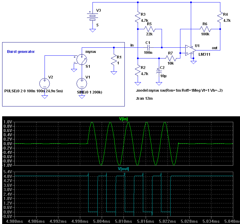

Any suggestions on how to wire up an LM311 as a sinewave to squarewave converter. The input signal is a burst signal comprising 5 nos. ~2Vpeak-peak, 200KHz sinewaves repeated every 5msecs. Will be using a single supply of 5Vdc.
What does "5 nos." mean? 5 cycles?
What is the DC level of the signal? What is the source impedance?
Sinewave to squarewave convereter using lm311
Thanks everyone for the responses.
Rolf, I do apologize for the incorrect technical term. Yes, its 5 cycles. The input signal doesn't contain any DC level. The signal is the output from the collector of a 2N3904 small-signal amplifier circuit - not sure of the impedance.
MRCecil, could you provide links for the circuit? Would I require feedback (hysteresis)? I tried an LM311 (without hysteresis and single 5V supply) but got a lot of noise at the output and no squarewave. I have attached the implemented circuit. Simulated okay in PSpice Orcad and worked well with input from a signal generator.
Appreciate your suggestions. The input signal is a burst of 5 cycles of ~2Vp-p, 200KHz sinewaves repeated every 5msec.

hi del.
Post your spice asc file.
To stop the oscillation you need a little positive feedback fro output to non inv input, try a 100K thru 1meg

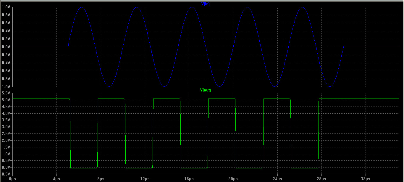

Here's an LTspice sim of my understanding of the OP's circuit.
  • LM311.zip
  • sine burst to square wave.asc

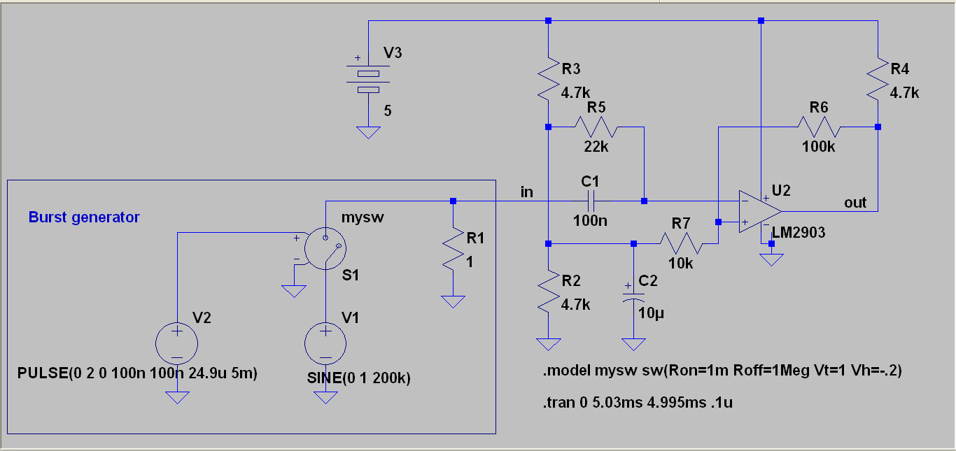

Hi Del,
There are plenty of different applications shown in the National datasheet I linked.
Roff has posted a sim for the LM311 that meets your specs. I will attach another simulation using the the same circuit (a tip of the hat to Roff for supplying the .asc file), but using National's spice model for the LM393/LM2903. The only difference I can see may be an 80ns rise and fall time without any overshoot with the LM393.
Good Luck,
Merv

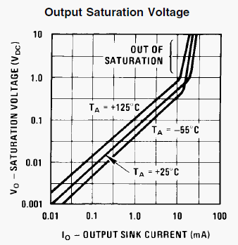

I am also partial to LM393, unless you need to sink more than about 4mA. I used LM311 because I thought our OP might have them in stock.
It will sink only 4ma? I thought it was capable of 12 or 15ma...I'll have to look that up so I don't screw up in the future.
Yes, it was good you did use the LM311 to display its capabilities, and a method of hysteresis he questioned. I found the 393 spice model several weeks ago and wanted to see how it performed in LTS.
Cheers,
Merv

LM393 worst case sink current is 4mA@700mV. Typically, it drops out of saturation at about 10-20mA.
Thank You! I had missed that in my latest design for a low freq input (0-1Mhz) for a freq counter preselector. I'll double check the works to ensure it's within specs. :eek:
