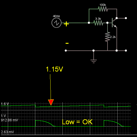

I use a sawtooth to represent a battery from 1 to 1.6V and set the threshold with Rb ratio to just below 1.2V
How do you want to indicate ok?
