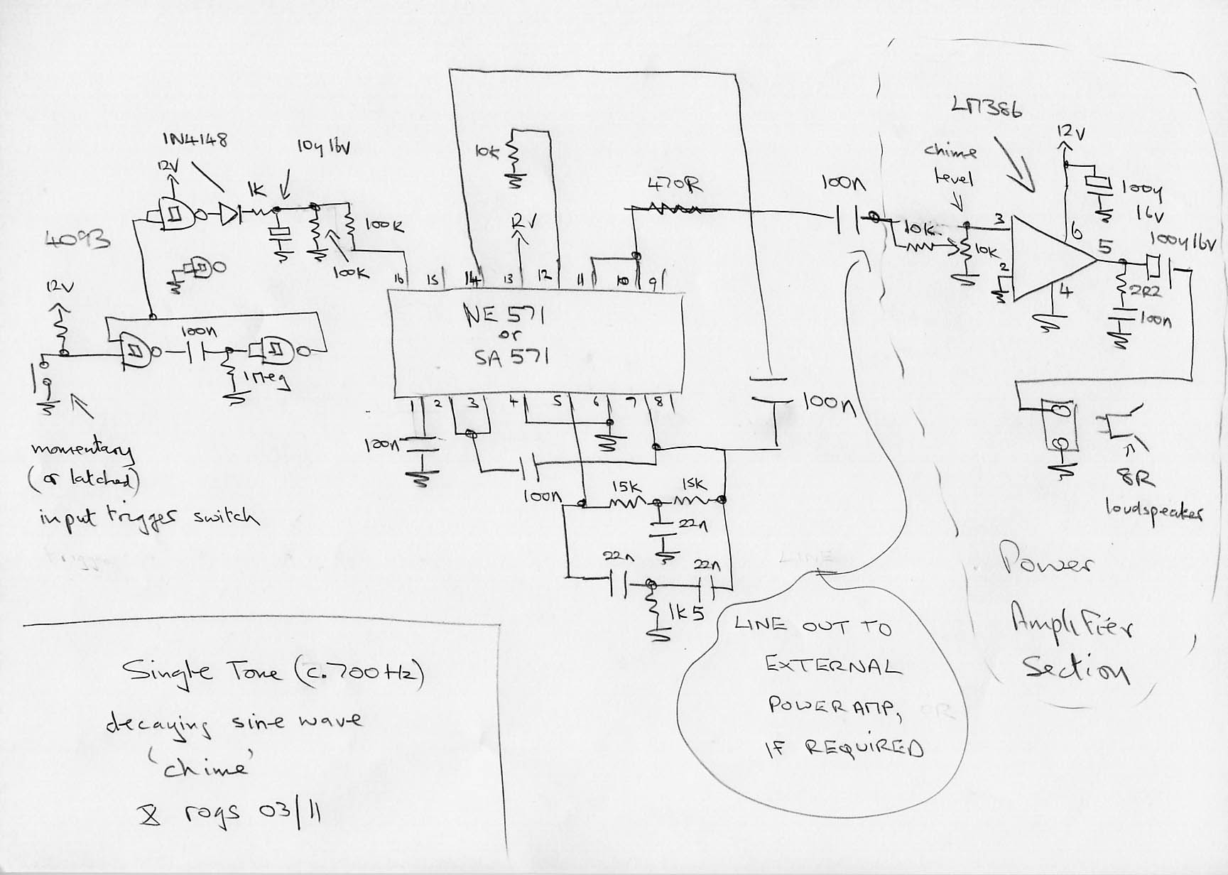

I've used the cicuit in the attached sketch as a single chime generator for a while now.
Sorry for the 'pencil sketch' . I'm not very familiar with all these 'sim' and 'schematic capture' packages -takes me ages to try and draw a circuit using them. So I tend to stick with what I know. Paper and pencil!
**broken link removed** a small mp3 of the kind of sound it makes
Oh man, this is great! So, if I leave the trigger switch closed, it will still only make the one chime? This sound is perfect, too!
Yes - you need to release the switch, and then close to again to make a new sound.
The CMOS 4093 IC acts as a monostable, triggered when closed to ground. Needs to be released, and re-triggered, to function again.

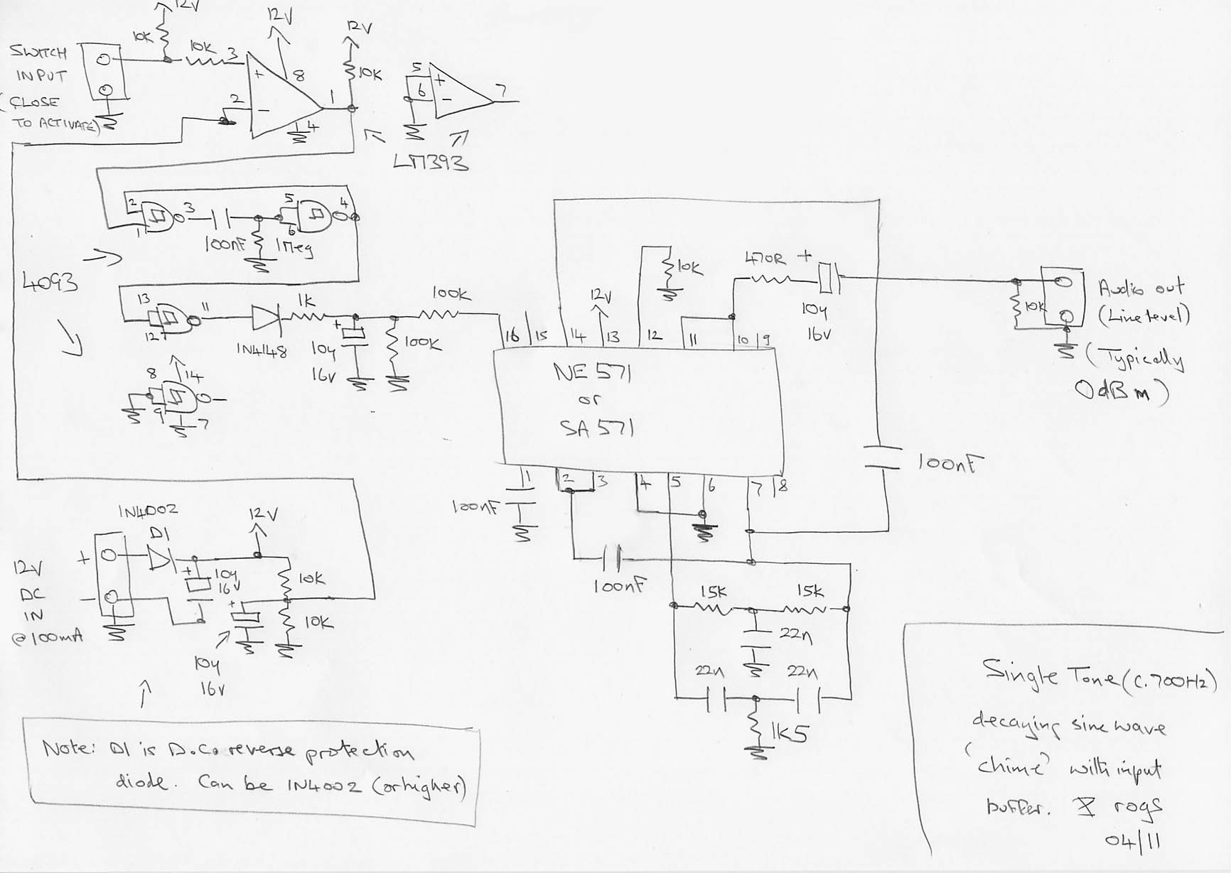

If this is the kind of thing you need, I ought to add a few more details.
I wouldn't really like to trust the switch connection to the outside world, to be connected directly to a CMOS input. Too easy to get a static 'zap'.
I see you are intending to use it as a line out device, so the power amp part of the circuit is superfluous.
I'll add a bipolar input buffer, to help with the CMOS ESD senstivity problem.
OK, modified circuit attached!
Yeah, this is just about perfect, I think. I'm not sure that the bipolar input buffer is necessary, since the trigger here is actually a relay (the person "buzzes in" which is really just firing a relay. This circuit would be triggered by one of those relays as it flips from open to closed. If that's enough to avoid the sensitivity problem, then great. If you don't think it is, then that bipolar input buffer might be the way to go.
I had a few other questions on that schematic just so I'm on the same page with you. I'm starting at the far left of the drawing:
1 - Just after the trigger, there's a line with an arrow to 12v. Is that a resistor? If so, what value? I assume it is, because without a resistor, that would create a short.

I had a few other questions about the schematic just to make sure I'm on the same page. This list works from the far left:
2 - The very next component is a Schmitt Trigger, right? I see the 4093 - do I need three of those chips? (Mouser link)
3 - Directly above the 100n cap, there's another Schmitt that doesn't appear to be connected to anything but ground. Does the other side go to something?
4 (last one!) - that funny looking cap (I think?) just after the diode that I think is labeled 10416v…I can't seem to find that part anywhere. Is that just another 100n, or is it something special?

Actually, I think your last drawing answered most of my questions. The pin numbers answered most of them...I assume the Schmitt with pins 7,8,9, and 14 does nothing, and you just have it there for completeness? The only remaining one that I have is about that 104 16v cap, if that is a cap. I don't think I've ever seen on drawn that way, but a search for 104 16v turns up a couple things. Is this part anything special?
One other question I have is about ordering these parts. If I check on Mouser, I see things like LM393AP and LM393P, for example. Do I care much about the letters after the 393? Both numbers mentioned are through-hole (or socket mounted, I guess). Is there some code I'm not aware of? :)
Thanks again...this is really, really great.
Heh; that was the hand-drawn schematic (my hat is off to the draftsman!). That's "10µ" (symbol for "micro", meaning microfarad). It's drawn funny 'cause it's an electrolytic capacitor (notice the "+", very important).
Regarding IC part #s and such, for your purposes it doesn't much matter what exact flavor you get. But you do want to make sure you get a part you can physically work with (meaning, probably not surface mount), so pay attention to the "package" type shown.
Oh right, NOW it makes sense. It just threw me for a loop because if you google for 104 16v, the first thing that comes up is a tiny ceramic cap. I think I have enough to go on now...thanks!
Ok, two more questions. First, coming off Pin 10 on the 571 - is that a 470K resistor? Just making sure. It kind of looks like an R.
Second - there are a couple of orphaned components, one from the 393 and the other on the 4093. I assume I need to ground these out as drawn, but do I need to do anything with Pin 7 on the 393? What about Pin 14 on the 4093 - is that going to +12v? Since that gate isn't doing anything, I'm guessing the output doesn't have to go anywhere (kind of like Pin 7 on the 393)?

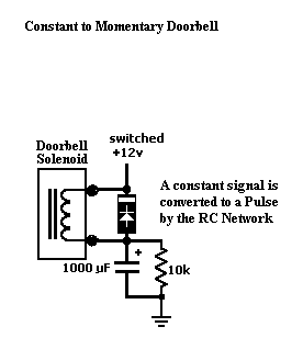

There is a LowTech way to do the same thing.
Well, yeah, that's kind of the degenerate form (mathematically speaking, that is) of a capacitive-discharge unit which I mentioned several replies above.

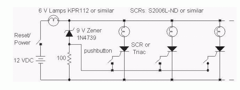

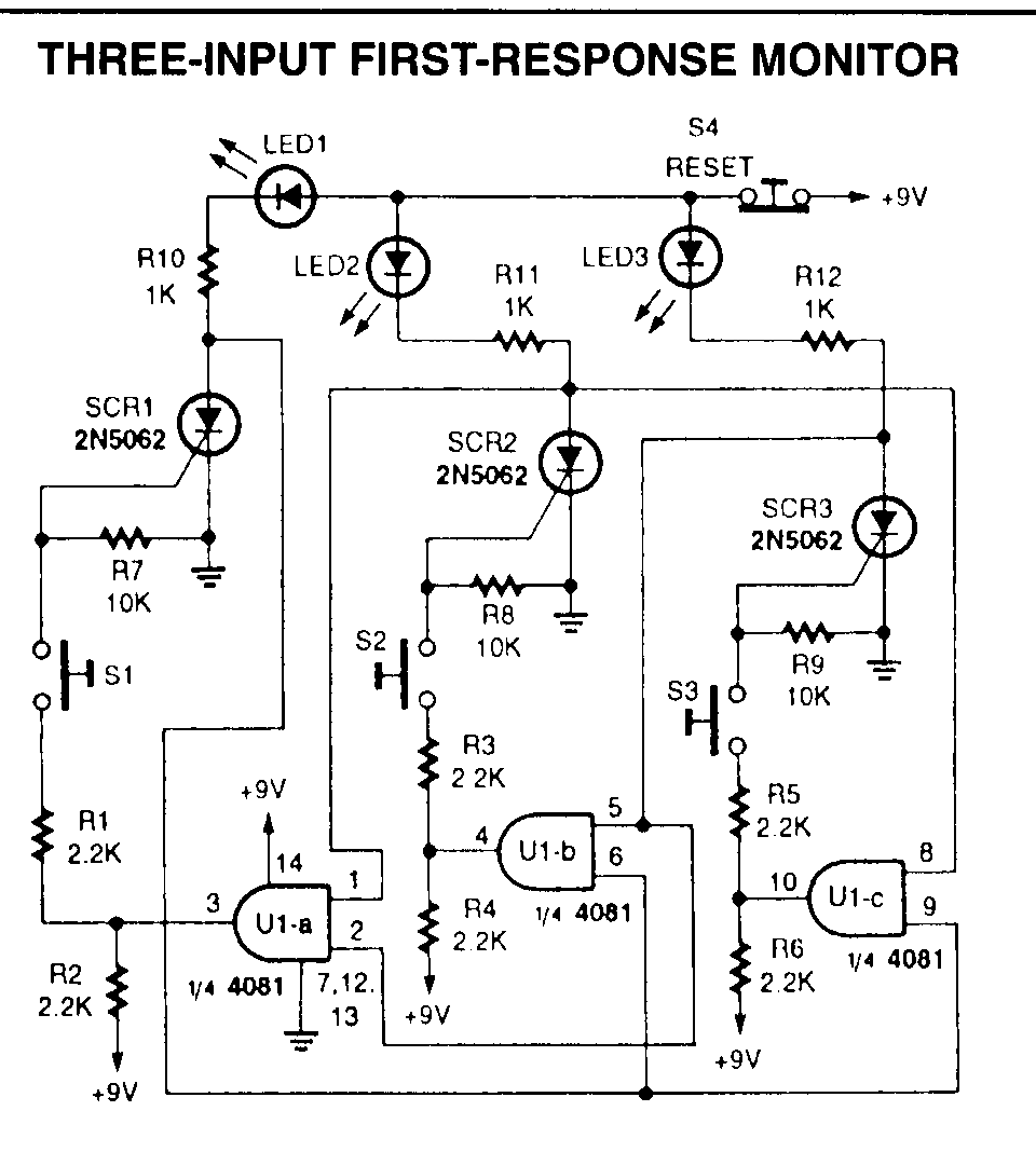

Here are a few simple Gameshow circuits
  • firstcircuit12volts.pdf
I ordered all the stuff from Mouser tonight, so hopefully it'll be here by the end of the week!
I really must learn to use one of these drawing packages! I can see why you have the queries - not very neat! Sorry.
The '470R' resistor is 470 Ohms, not 470K. Just used to define the minimum load for the op amp output from the 571 to work into.
Yes pin 14 of the 4093 goes to 12V. My bad!!
Yes the unused gate in the 4093 has the inputs grounded. No connection to the output. Same for the unused section of the LM393. No connection to pin 7.
The 3 electrolytic capacitors are all '10uF 16v'. The remaining capaitors are either '100nF' or '22nF'.
Pins 8,9 and 15 of the 571 are not connected.
SWEET! I just breadboarded it and it works like a charm (once I got past my own mistakes).
One more question - Is it possible to have the sound decay a little quicker? If not, or if it's more than just swapping a component with a different value, then it's not a big deal.
