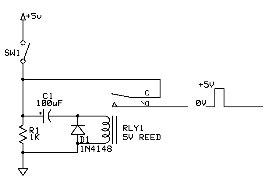

I just ran across this thread, and have to go back and through in a relay solution for the all-relay Jeopardy game chime. The attached is a relay monostable that would be used to pulse the chime solenoid when the responding contestant's relay is closed and held.
The pulse width depends on the relay's coil resistance, the relay's dropout voltage, and the size of the capacitor. It's old technology, but it does work well. ;)
