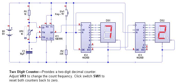

several ways of doing this really. as your not a master of electronics i would sugest this as the best:
this will only count in decimals so you might have to measure in 100s of seconds
ok you want a clock first, somthing to set the time base for your counter. if you know how to make one a 555 Astable would be perfect, if not use a RC circuit. I've used a 555 Astable in my circuit i would think you want a time base of about 1second
The 7segment counter/ decoder powers the 7 segment displays, with "10" pin acting as the clock for the next counter decoder. as i say this only counts up in 1, 10, 100, 1000. you can keep adding an extra digit onto it.
if you really need a time format number (9:59) i could make a few changes to the circuit if you want?
Also i assume you want it so it activates when the gate is opend and stoped when the boat reaches the end? if you design a sensor arangment for that as well??
but why not just use a stop watch??
The circuit will need a 100 nF ceramic bypass capacitors across each 4026.
You could make a 4026 work as a modulo 6 counter by inserting a 7 input AND gate (one input inverted) to detect when the outputs = 6 and thus apply a reset.
It also needs start and stop logic, but that is easy. I suggest an RS flop Flop.
The 555 oscillator won't be very accurate, a crystal osc would be better.

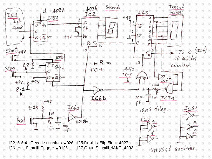

Here is my suggestion Edit - it is based on the circuit posted by Misterbenn. Text below and circuit edited to correct errors and to affect a minor improvement.
Circuit description
When the power is turned on C1 is discharged so the output of IC6a goes high and applies a reset pulse to the counters & IC5b.
When the voltage across C1 reaches the upper threshold of IC6a, the reset pulse is terminated.
When the start button is pressed, Q2 goes high and the counter starts counting.
When the stop button is pressed, as J is low and K is high, Q2 will be set low and the counter stops counting.
When the reset button is pressed, counters and Flip Flops are restored to their initial states.
Counter IC3 counts in modulo 6 because when the count reaches 6, b is low and e is high. Thus the output of IC7a goes low and after a delay of about 10 microseconds IC3 is reset. The purpose of the delay is to filter out decoding spikes that may be present in either the b or e signals.

I modified the circuit and description posted above to correct minor errors and affect a minor improvement.
Len
