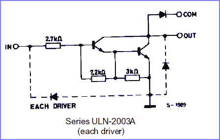

I'm controlling the brightness of a group of LEDs with a ULN2003A by PWM'ing the common GND. I need seperate control over the volume of a piezo buzzer using a similar device but only need one output, rather than the seven provided by the ULN2003A - I would be very grateful for suggestions as to a suitable device.
Use one NPN transistor with a base resistor.
If you prefer, you can also look inside the ULN2003a datasheet, reproduced here for your convenience.
I hadn't thought to look inside the data sheet like that - cunning stuff!
Thanks for your help!
Richard
