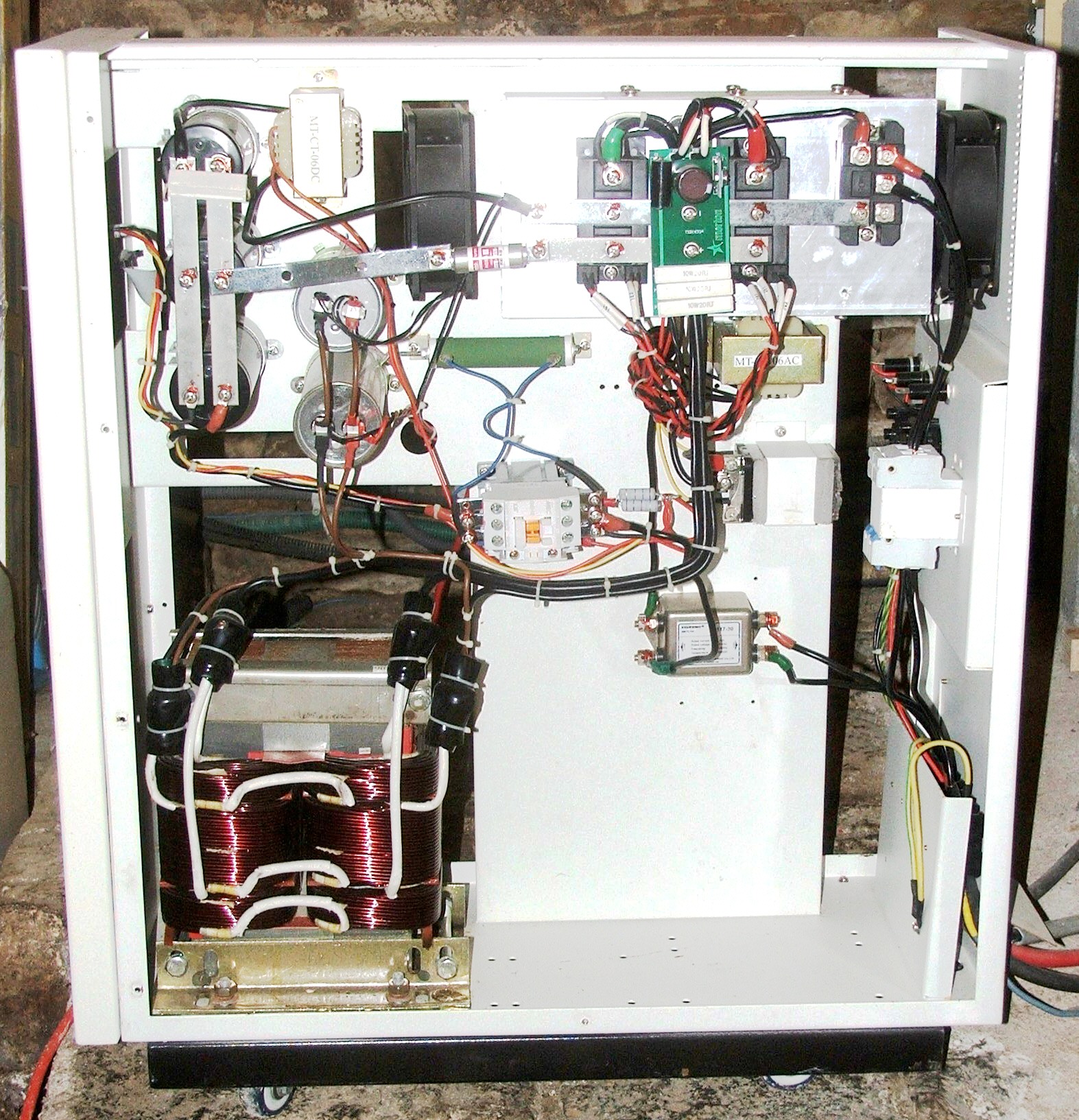

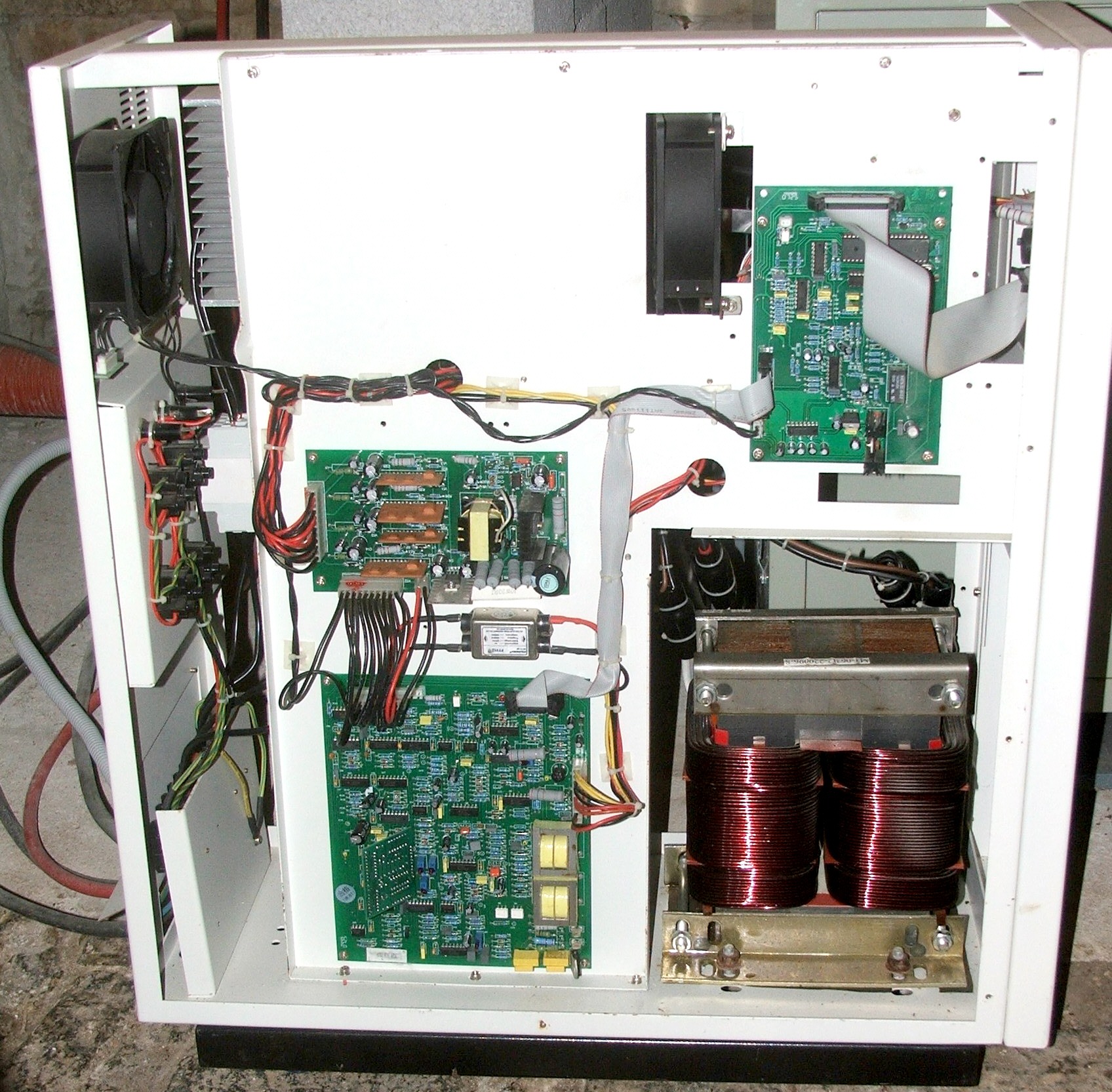

I've taken a couple of photos of the unit so that that layout will be visible. As I said I've no schematic to go by on this one so I've not much information to offer. The two photos show the different sides of the unit; it's about three feet square to give you an idea of size. The transformer is mounted on the base of the unit and there's a huge fuse in the center of one side (no, it's not burnt out) but other than that I'm not sure of the function of the other large components.
I do understand your explanation of how the unit functions and what the probable cause of the problem is, but I'm more familiar with small PCB mounted components and not these large solid state power devices. When you talk of a MOSFET I think of something like a transistor but I know that I am in the wrong realm!
If someone could point out what's what from the photos I'd be most grateful. Thank you.

Your H-bridge is on the upper right in the first photo. Those look like IGBTs (Insulated Gate Bipolar Transistors) between the fans. Below them looks like an inductor (filter) and a contactor (relay) on the left, next to the green power resistor. On the right of that contactor looks like a rectifier, and below those a line filter. On the upper left are five large electrolytic capacitors and a smaller transformer.
The boards control much more than an LCD; they are running the inverter. I'm guessing the microcontroller is the 40 pin DIP on the board in the upper right in the second picture.
Is this made by Toshiba? Oh, never mind that - I see in your first post it is Chinese made. Few of the manufacturers of these things are of any help.

Looks like just a push-pull design with two insulated gate bipolar transistors. Not sure with the third smaller one at upper right is for.
The two caps with brown wires are AC output filter caps. The three caps in parallel at far left are filter on DC power supply.
At least check the DC fuse on the large flat wire above the middle-left fan.

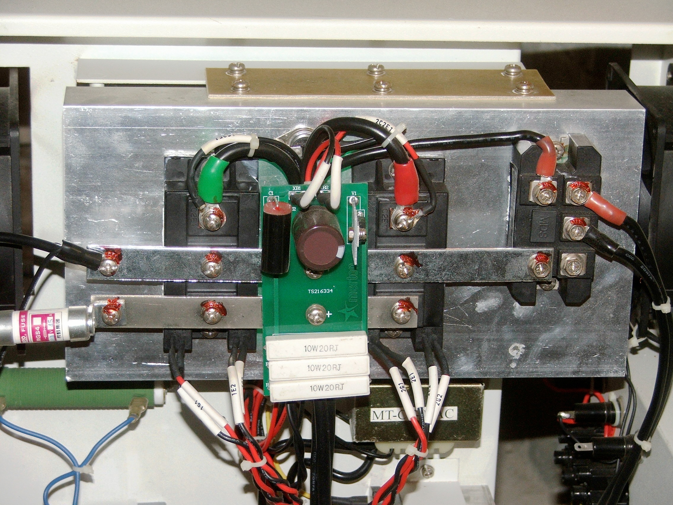

I’ve been looking at the H bridge and I’ve been able to get the part numbers from the power transistors (or whatever they are):
2MBI150N-060 150A 600V 73007 Japan FE
Both power transistors in the bridge have the same part number and maker but for some reason the barcodes are slightly different.
Anyway, I’ve found a couple of suppliers but before I replace the parts is there any way that I can check that the components in place at the moment are actually faulty? As you can see from the photo there’s no obvious sign of any burning and I’m not sure how to determine what has caused the failure. You can blow the photo up quite big and I don't think you'll see any damage around the terminals, but there again I might be looking in the wrong place.
The black component to the right of the H bridge seems to be a three input bridge rectifier. It takes the input coming from the battery bank and must filter out any ripples that are left from the generator that is used to charge the batteries (a wind turbine). I’ve checked out the fat fuse on the left of the H bridge and it seems to be OK.
Any suggestions on how I can check out the power transistors?

They are insulated gate bipolar modules with two devices in each package. This explains the strange hookup and the two modules form an H-bridge.
These puppies are likely quite expensive and I would not buy replacements without some trouble shooting to be sure they are cause of failure.
  • 2MBI150N-060.pdf
I agree with RC; not only are they expensive, but also quite rugged. I would do some probing and measuring before ruling anything out.
Are there signals on the gates? Is the micro-controller running?
