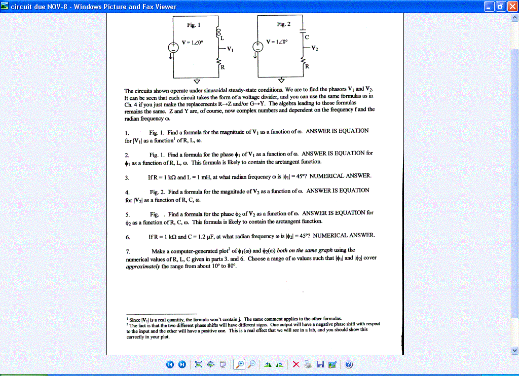

I have a hard time to figure out these proplems in the picture.
Here are my solutions:
1) V1 = V*R/(R+ L) (voltage divider)
but we have V = cos(wt)
=> V1 = cos(wt)*R/(R+L)
2) L* di/dt + R*I = V1*cos( w*t + **broken link removed** )
==> V1 = (L*di/dt + R*I)/cos(w*t +**broken link removed**)
3) ?
4) V2 = R/(R +C)
5)?
6)?
7) ?
thanks for looking

Two hints:
1. Inductive reactance=jwL
2. Capacitive reactance=1/jwC
You are using L and C for the respective reactances. This is incorrect.

It is a voltage divider:
V1 = V* R/(R+jwL)
and also if you remeber your complex arithmatics you should be able to find the magnitude (and equally the phase) for this equation
|V1| = SQRT( Re(V1)^2 + Im(V1)^2 )
