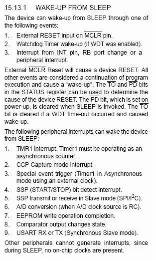

Is it possible to have a 16F88 wakeup from sleep for a RX interrupt, and how would this be done? With no lock the SPBRG is useless, no?
The code I've written that I thought might work just stays in sleep.

You can't do it if the USART is in asynchronous mode... No on-chip clocks are running...
Regards, Mike

Perhaps you could wire the Rx line to not only the Rx pin but an RBx interrupt pin. As soon as the line transitions it will wake up the device if appropriately configured.
That would wake up the PIC, but, if the USART is configured as asynchronous and none of the PIC clocks were running while it was asleep, would that start bit be picked up by the USART module?

No, you need to have BaudRate generator running to enable reception.
My Idea is to:
1. Disable USART before sleep
2. Enable PortB on-change interrupt
3. Go to sleep
4. Send AAh char from PC
5. PIC will wake-up and enable USART
6. recieve valid char
The only disadvantage is that first Char can't be received...

Is there anything in the datasheet that says it CAN wake from the USART?, I wouldn't have thought so?, as already suggested the USART will be shutdown with the rest of the PIC.
How about just using a software UART?, you could use a change on an external pin to wake the PIC, then go straight into a software serial routine, on the same pin - you could make the initial half bit time delay shorter than normal in order to compensate for the waking time of the PIC.
Just noting that the pic's wakeup time is very fast compared to serial comms. You probably won't lose much timing.
