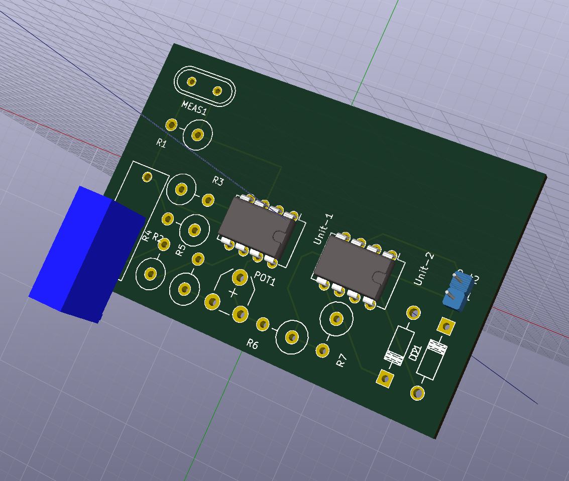

Is the TLO82 a Dip 8 or a SMD 8? That you want?
I only work with through hole components and yes the DIP8 are correct. I use perforated boards with copper dots on one side like the one depicted below
That is a circuit developed with the help of you guys here

In Pcbnew. Place the cursor "cross hair" on top of a footprint.
Hit "E" for edit. under Footprint Properties... Select "3D Setting" Browse to you 3D part and select
Hi Will,
I did what you said and yes there is a new piece on my PCB bit wrongly seated ¿?
x and y offset is how you finesse it when needed.
