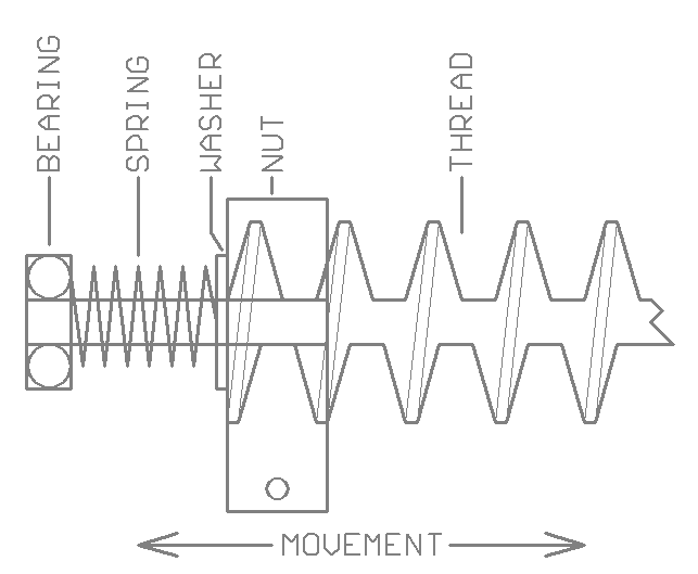

Yet another idea:
Using a threaded iron rod (M8 to M12) and connecting geared motor to it you can drive the nut at high speed and have a lot of power.
I built such a device for a model sailboat winch to avoid entangled cables when passing through the wind. (Don't know the English term. The maneouver is turning the boat through tailwind - Halse)
The sail has be pulled almost alongside the boat to be released quickly when turning through the wind.
The higher the M-value of the rod the steeper the thread. M12 makes about 2mm per revolution.
To avoid jamming of the nut when the maximum length is reached remove the thread at both ends of the rod and use push springs to press the nut onto the thread again when reversing rpm, about like this (attachment).
Boncuk
You certainly do not want a triangular thread, you want a square thread for this application. That saida triangular one might just work fine.
I'd agree that an Acme or square thread might be preferred and also agree that a common thread might be sufficient. Worth noting is that McMaster-Carr, MSC and other suppliers (who sell small quantities) have Acme rods and nuts at low cost (low in my opinion). Small Parts Inc might be another source.
Hi superfrog and stevez,
the drawing was made using the Eagle schematic editor.
Although the thread might look triangular it should represent a normal DIN-thread like used for screws.
I also guess that even using a triangular shaped thread the accuracy is of less importance if limit switches or Hall-sensors are used.
If you take a close look at any thread of a screw you'll find it triangular. :)
The threaded rods I mentioned are used in building constructions to support loads (e.g. cable bridges) mounted to the ceiling and height adjustments are easy with them. They are sold in Germany in home markets by the meter.
Boncuk
