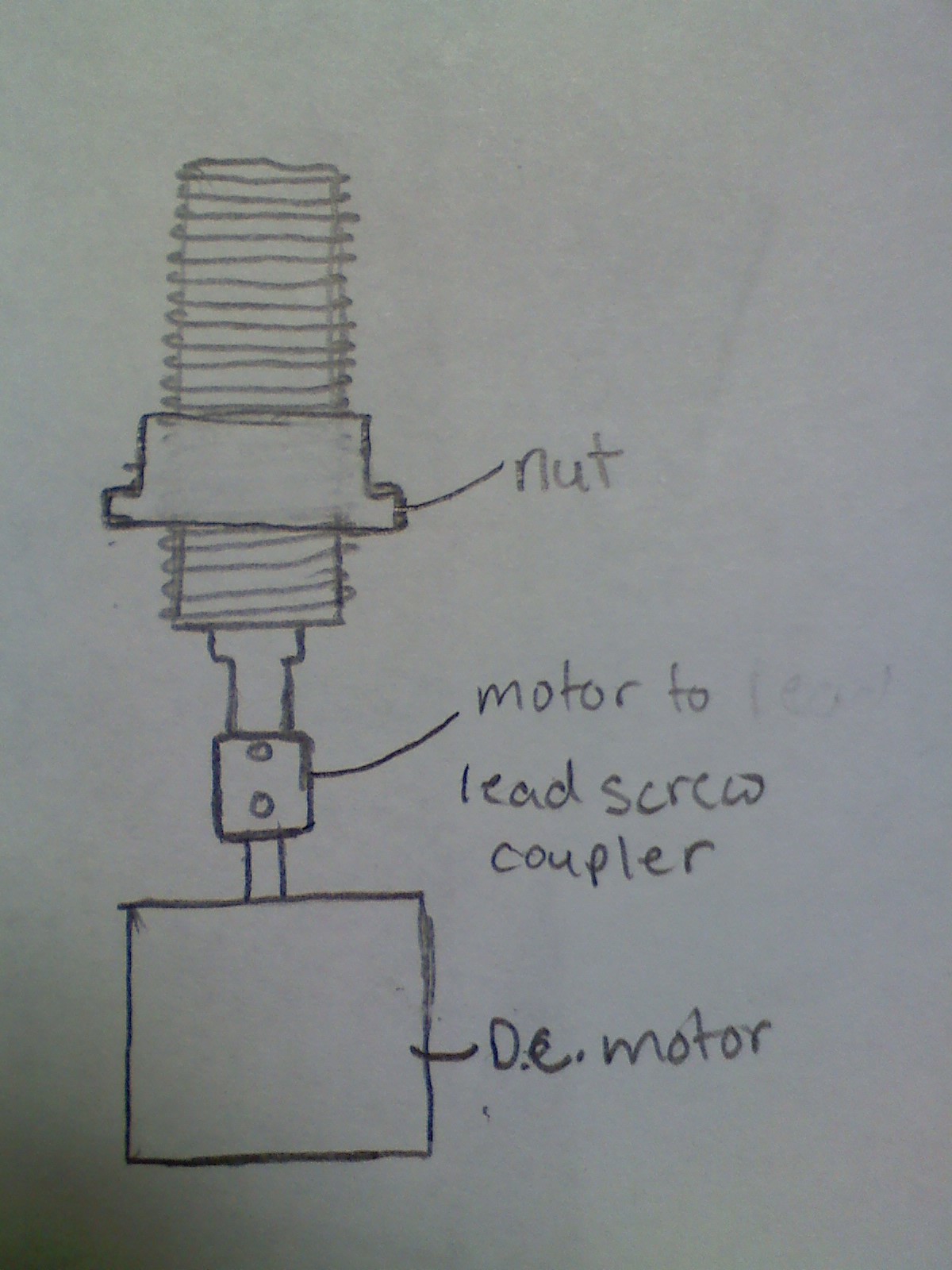

Im going to draw some pictures of what im wanting and upload em. Its scale will probabaly be a bit off...don't laugh :/
Here it is:) Its a real dummy but you get the Idea. Looks Like the shaft isn't supported but the Hex nut will be and it never fully leaves the shaft:) Its going to be fun finding a small motor. I was looking at the window lifter motors at amequipment and they are 7 inches long-ouch!! I need something SMALL!

Hi, can you at least give an idea of what your doing? I understand that your trying to build something to market to people. but to get help on how to do something we have to know what the object is doing.
There a lot of ways to do a lot of things, but more information is needed to help.

It's the nut part, the one on the screw that moves up and down. They come anti-backlash but since I'm not looking for precision I think just a regular nut would be sufficient. The part that I'm really looking for is a relatively inexpensive motor that is pretty small ( maybe pancake ) and strong, by tomorrow I'll figure out how strong.

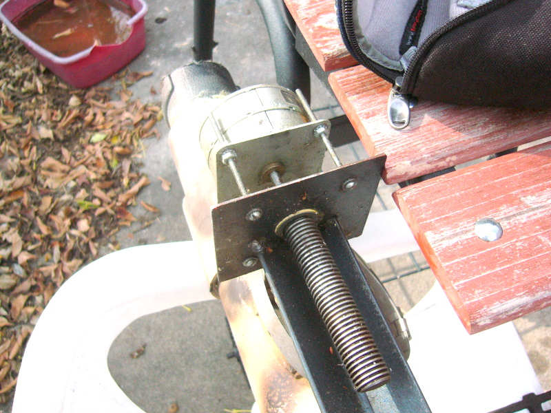

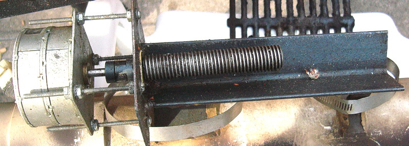

The pictures here are something similar to your sketch.
However there is another part that is not shown. A separate piece of angle iron has an acme nut welded to it, and rides in the groove of the piece shown in the picture, as the threaded acme rod that is shown rotates.. ..... I would have included it ... but it seems to have gone missing.
The motor here is a stepper motor, but you could just as well use a DC motor of some sort.
You can see the shaft coupling between the motor shaft and the end of the acme threaded rod.

Stepper motors are rated for high axial loads, a size 23 (similar to photo) is usually rated for around 5kg to 6kg axial load. That's about 11 lbs.
But DC gearmotors don't have the quality bearings that a size 23 stepper motor has. They can have huge torques but the output shaft of the gearbox is poorly supported and uses crappy bronze bearings, not precision ball bearings.
You need axial load rating on the leadscrew bearings of maybe double the actual 15lb load, to allow for friction and inertia. So you need something rated for >30lb axial load.
Inexpensive pancake motors won't have high axial load ratings, usually in one axial direction they are held together by the rotor permanent magnets and on the other axial direction they have a tiny nylon washer. They are probably the worst possible choice of motor to couple direct to a leadscrew!

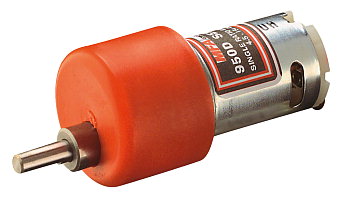

Hi deesnyas,
I suppose the load will be connected (moved) by the nut while the thread is spinning.

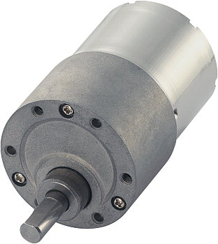

Here is a suggestion of a powerful DC-Motor (4.5 to 15V) with various ratio reduction gears.
The torque values in the datasheet are given in g cm. To calculate for nM divide by 10,197.0
I am using a real small motor (dia 12mm, reduction gear 14mm) to drive solar panels the way I described earlier in this thread. Speed is no issue to track the sun, so those small motors and reduction gears are fully sufficient.
Moving an object 1" in less than 1 second depends on rpm and pitch of the thread.
I guess you don't want that actuator heavy and bulky. One motor is about 28US$ and worth an experiment. The motor type is 385.
Alternatively you might use an RB35 (available with different ratio gear boxes as well), made in China, priced approximately US$15.
Regards
Boncuk
