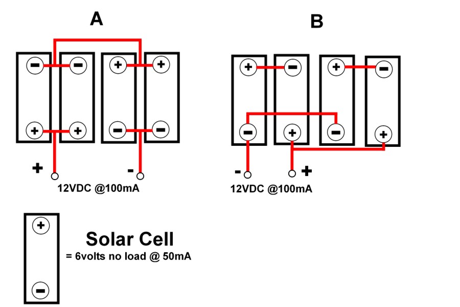

I'm looking to wire 4 (maybe more, if needed) solar cells in series/parallel to get an output of 12v @ 100mA. Two configurations come to mind, and I'd think the output would be the same. I have no experience to draw from, so figured I'd ask and see if it even matters. Did a quick diagram, attached.

I think you will find that diagram A results in a series circuit, so your current would be 100mA, whereas diagram B is in parallel, so you end up with a max of 200mA.
the general rule with solar panels is to series connect the fewest panels needed to get the voltage you want, then parallel up sets to increase the current output.

In circuit A, I have 2 sets of 2 parallel wired solar cells, these wired in series.
In circuit B, I have 2 sets of 2 series wired solar cells, then wired in parallel.
Both are a combination of series and parallel.
So, in the first, 6v@100mA + 6v@100mA =12v@100mA
Second is 12v@50mA + 12v@50mA = 12v@100mA
There are 4 cells in the array, each cell is 6 volts (no load) @ 50 mA.
I want 12 volts @ 100mA output from the array.
My bad, was squinting at the diagram, should have opened it. Anyways, B is the better way to do it. Partial shading has a greater effect on some panel designs than on others, with B, you would maintain your terminal voltage more often and have less panel heating. I realize these are small panels, but I think its still the way to go, and is the way Shell, Siemens, and US Solar suggest I should do it for my applications at work.
My point about series and parallel was that the general " style" of the array was either series or parallel. In circuit A, shading some panels has a far more drastic effect than shading some panel in circuit B.
Thank you, this is what I needed to know. Also, are any blocking diodes need to seperate cells, or just between the array and battery. Wouldn't a shaded cell take away from the active cells?
I know that the batteries will discharge through the panel, without a blocking diode, seems like inactive cells would draw power.
In practice, you really only need to separate the "branches", that is the finished series sets of panels from each other. That is the problem in circuit A, there is no place for the blocking diode, except at the output, so you get an "all or nothing" array. So in circuit B, you could have a diode at the end of each series section, and no more battery back-feed, and no panel back-feed either.

i think both are the same circuits.in figute A if we interchange cell2 and cell3 we will get the figure B.so according to me both circuits have same characteristics

Perhaps this will help you see the differences a little more clearly. It was a bit confusing for me also until I redrew them:eek:

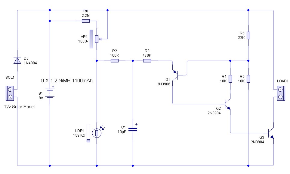

The attached circuit is what I used to charge the batteries and switch on at night. Going to replace the diode with a schotsky (sp) when they get here. Haven't been up to the hardware store yet to get what I need to weatherproof and mount it outside yet. Still a few details to workout in that department.
The switching circuit works pretty good. I had a simpler design, but it slowly came on as it got dark, which wasted power. Not to mention to early.
