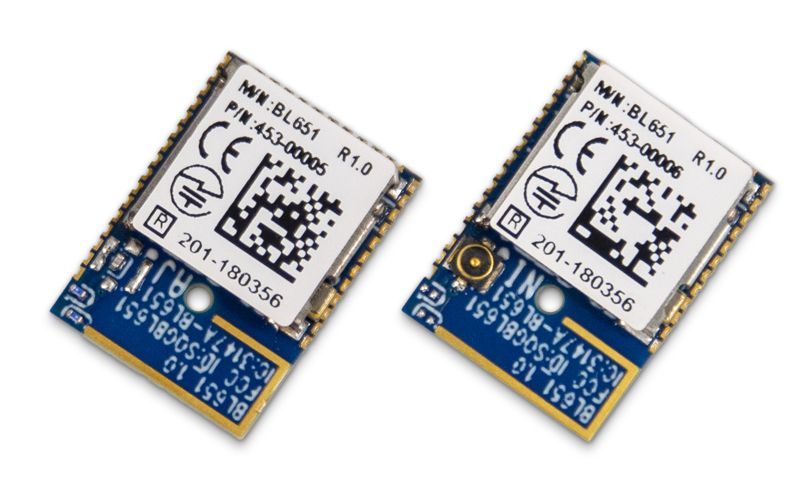

If you're asking about how to make a PCB, I assume your skill level is minimal and you may be biting off more than you can chew here. But, to get you started, you could try a Laird BLE651 development board. It has the Bluetooth controller on the board and some free pins that can be programmed to control your LEDs. The battery will be extra, the board is 10mm x 14 mm so it will fit on an 18mm diameter coin you defined.
You'll have to download the Nordic SDK and figure out how to program the chip on the development biard.
Size wise, without the battery, It will look like...
