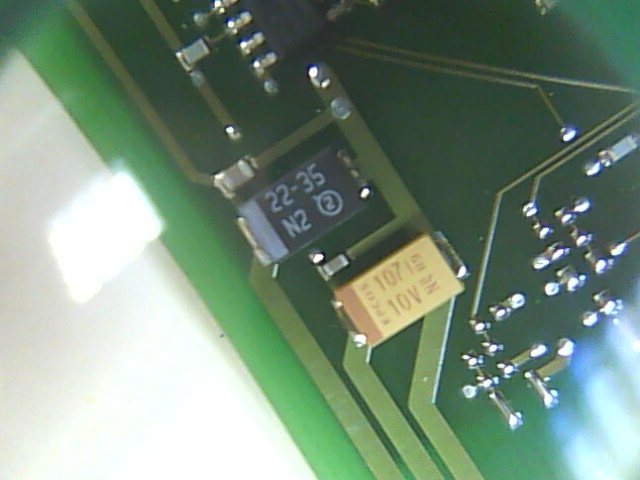

Hi again,
Attached is a photo for a similar component to a blown one in a faulty card I'm trying to repair. As an prehistoric technician, I'm not much familiar with SMD so, I do not know what are these two components.
I do contact EBCOS company and amazingly, the swift reply me, the yellow one is " tant chip capacitor" when I asked about its value and the identity of the black component, they gently excused that they can not help me.
Any body can help for the value of the yellow capacitor and the identity of the black one.

Thanks for your help, for the black one, similar idea came to my minde, but the 2N diverted the whole things.
Is there any problem -except for the space- to replace them with the ordinary snap capacitors.
Thanks again.
colin nailed the values, both are tant caps, and the line indicates positive, unlike the line on a diode or aluminum electrolytic cap which indicates negative!
without seeing more of the board, can't tell you what an appropriate replacement, other than the exact same thing, would be. sometimes tant are used because of low esr, high frequency, etc. sometimes they're just used because they offer high capacitance in a small size.
