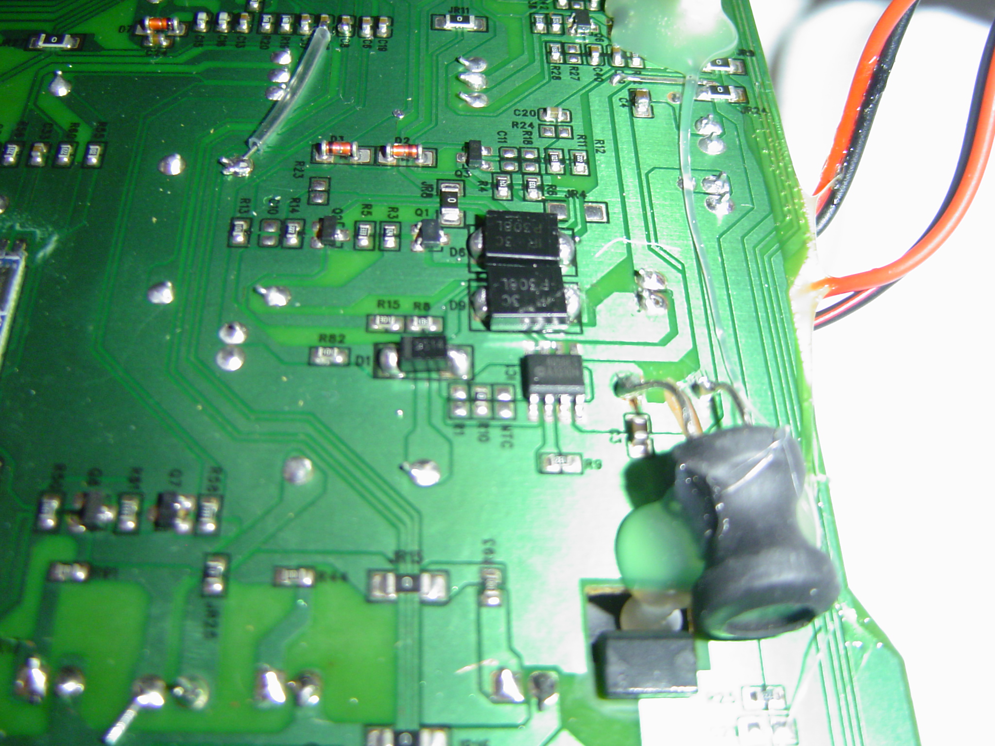

I am repairing an iLive IBB683B Boombox. I have isolated the problem to diode D9. The markings on the diode are:
Upper Left "IR"
Upper Right "3C"
Middle "P308L"
Can anyone help me identify this part. I have looked everywhere with no luck. the size of the diode is approximately 5mm x 6mm. Maybe an SMC package.
see pictures. Two diodes in the center are the ones I am looking for. Thanks.

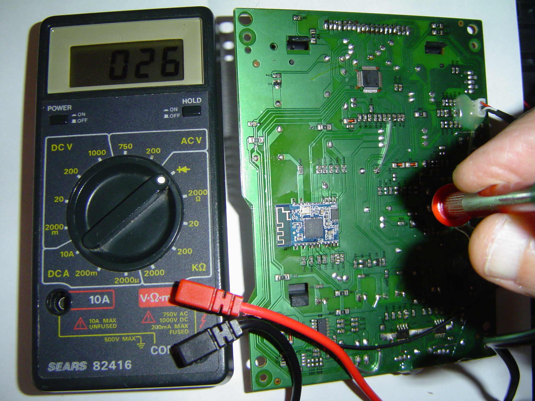

DerStrom8 Thanks for the response. I tried the diode function on the meter. It seems to give me the same results as the resistance test. Not sure why. I misspoke before. The reading I get is 25 ohms in each direction. I am pretty sure the diode is hosed. The real question is what to replace it with.
The diode test does not measure resistance, it measures voltage drop. A good diode will usually drop either 0.3V or 0.7V (maybe higher for high-power diodes or Zener/TVS diodes). What exactly did your diode test function display when you connected the probes across the diode in each direction?
I thought that was the case. I am using an old Sears 82416 meter. In the diode test mode i still read 025 in either direction. I guess 25mv? I tried another meter and I get the same result in diode mode. The other same type diode measure 172 in one direction and 656 in the other. That one I think is good.
Those numbers mean nothing. Where is the decimal point? There should also be an indication of the units on the meter's display. Please post clear photos of the multimeter display while performing these tests.
Sorry for the confusion. Those are the readings I am getting. There is no decimal point. I assume the units are millivolts. 0.025 volts in both directions for what I think is the bad diode. I checked a 1n4001 out of circuit to see what I get for measurements. Positive lead to anode and negative to cathode i get a reading 612 millivolts or .612 volts. Exactly what you would expect for a good diode. I attached a picture showing the 025 reading. In fifty years of repairing electronics, I have never been wrong assuming a bad diode with the readings I am getting. I suppose there is always a first time.

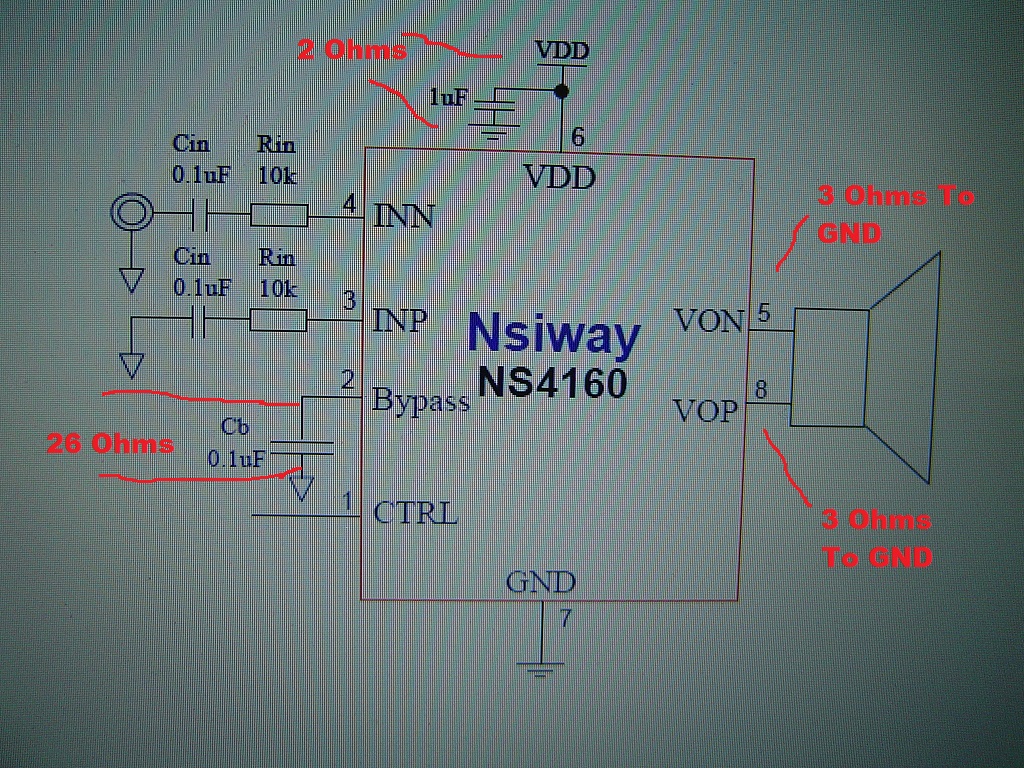

Okay I was wrong. It wasn't the diode. Good catch Dersrom8. I should have listened to you. Prior to removing the diode I decided to probe around some more and I found some strange readings around the left audio amplifier chip. It is a NSIWAY NS4160. See attached circuit diagram. I was able to disconnect the power to the amplifier chips by disconnecting a convenient jumper. Once I did that, the diode acted like a diode again. So it appears that the problem is in the left audio amplifier circuit. I annotated the drawing with the readings I am getting. The ones I think are strange are the 26 ohms across Capacitor Cb and the 2 Ohms across the source to ground capacitor. Both are small SMD caps which I have had problems with on other repairs. They usually short out completely though. Any thoughts on whether it is one of the caps or maybe the chip itself? The right side amplifier has a good reading across Cap Cb. The other readings on the right are the same as noted on the diagram.
