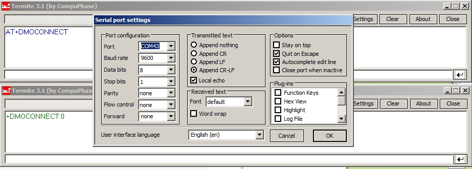

Hi, Here's another example of the problem:
Minicom, screen, PuTTY, and various other terminal clients were giving me a very rough time with these units. The initial handshake command is “AT+DMOCONNECT” with the carriage return and line feed characters. With the terminal programs I listed above, each character was individually sent, and I was commonly seeing “+DMOERROR” as I was trying to type out AT+DMOCONNECT. Python was the tool that finally worked.

I contacted the complete radio designer see #1 and told him about my terminal woes, he said he uses Termite 3.1, so I tried it and here's the successful result.
C.
