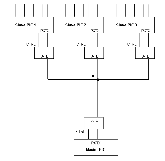

I don’t know 485 protocol so I’m going to use UART method for this. See my drawing.
In standby mode the bus will be in high impedance. Disabling all the drivers using CTRL lines & they are ready to receive data.
I address each slave PIC as 1, 2, and 3.
Now I enable driver in master PIC & send “1” using UART TXREG. That is slave PIC 1 address. All slave PIC’s will get this value but only slave PIC 1 will match this value. After matching it will enable its driver by CTRL line & send its data to the master PIC.
I must make sure at each time after sending data I must disable drivers by each PIC’s CTRL lines.
Is this going to work nicely?

I think this is a version of Mikes advice, use an external interrupt for detecting which Slave is to send the data, have the same bus for data transmission.

Hi Suraj,
You've got the idea. As far as a protocol, there are lots of ways to do that too.
I have used a short distance one pin Icom CI-V serial buss (5 volt signal levels) and protocol in the past with very good results. The protocol defines data records with a "header" or "preamble" byte, "address" bytes, a "command" byte, optional "data" bytes, and an "end-of-record" byte.
