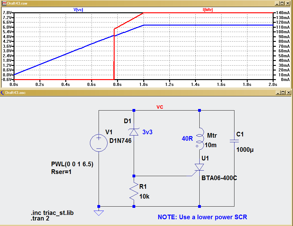

is there a way to autostart the fan? like a fet on the output of the cap?
Use a 1000uF as suggested in post #3
For a autorun circuit use a 4.7V zener to trigger the gate of a 1Amp SCR, choose an SCR that has a low hold on current and a sensitive gate.
EDIT:
This is one option

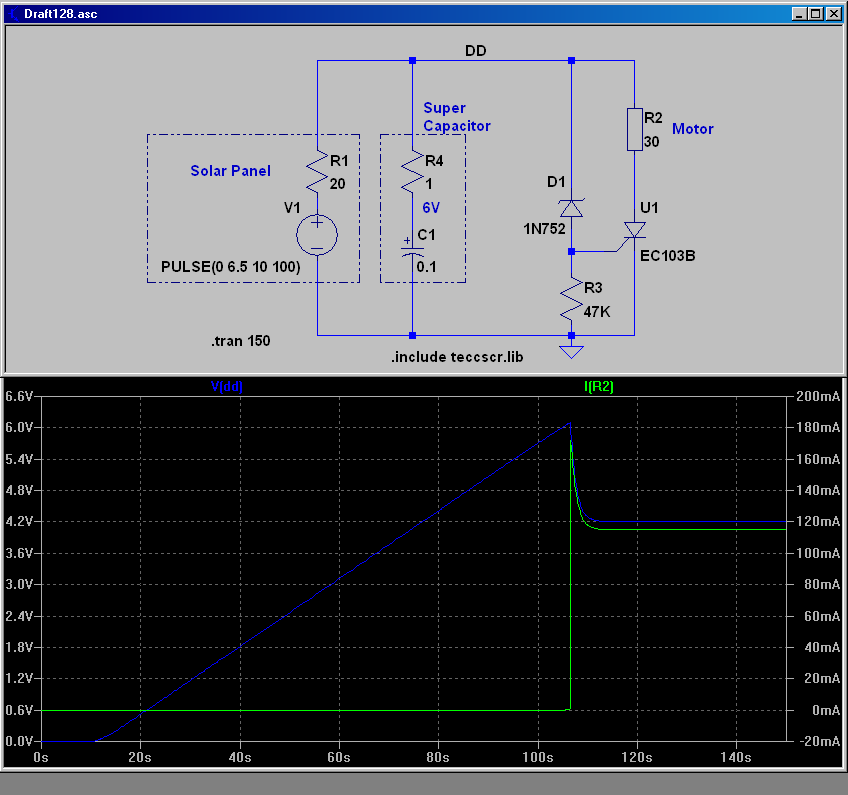

I think you need a much bigger capacitor, and the capacitor must have a low Effective Series Resistance. For the capacitor to hold the voltage up for ~2sec while the motor comes up to speed, it will have to be ~0.1Farad (100,000uF). Looking at the cost and available specs on Super-Capacitors on Digikey, I'm thinking you will do better to use a rechargeable Battery. In that case, the voltage rise sensor will have to be very precise.
Here is a sim of Eric's suggestion with a 0.1F capacitor.
