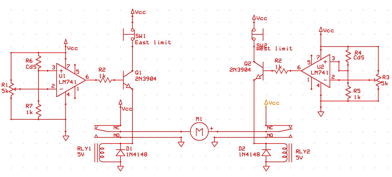

you can share any problems here, i just want to say though that i think that everyone in this thread is being a little redundant. you don't need to use stepper motors, in fact if 3v0 was here he would beat you all senseless with your own ideas. you can get the same results using this circuit. if you have any problems with the circuit, then let me know and i will fix them, i think that i made a minor mistake on the two inputs on both op-amps. if you have a problem then switch the inputs on pin 2 and pin 3 on both op-amps before you come to me please.

if you want to know how an op-amp works in detail, then read this: READ!!!. if you want a long story short; most op-amps can handle a dual rail power supply. when the non-inverting (+) input is higher than the inverting (-) input then the output is high. depending on weather the op-amp is on a dual rail power supply or not, 2 different things may happen;
1.) Dual Rail: if the op-amp is on a dual rail power supply, then when the inverting input is higher than the non-inverting input then the output will read a - voltage in respect to ground (the op-amp is trying to allow current to flow from ground to the - voltage source.
2.) Single Rail: if the op-amp is on a single rail power supply, then when the inverting input is higher than the non-inverting input, the output will be 0V.
see that 30pF capacitor? that capacitor is in most op-amps, but it's value may vary depending on the op-amp. this capacitor causes what's called a slew rate in the op-amp. the slew rate is simply referring to the frequency response of the op-amp. as a rule of thumb as the frequency increases, the response of the op-amp decreases. once you pass a certain point then the op-amp stops responding all together. for the 741 operational amplifier, which is the one in both of my images, the drop out frequency is about 1MHz. if you have an op-amp and you want to know what the characteristics of it are; you can look it up on this site: LOOK IT UP!!!

There's nothing wrong with the idea of using steppers for this application, and it's actually a cleaver idea. But the system needs to be better specified. Properly done, the stepper system can provide a certain amount of damping, and thus better control, something the bang-bang opamp circuit doesn't have.

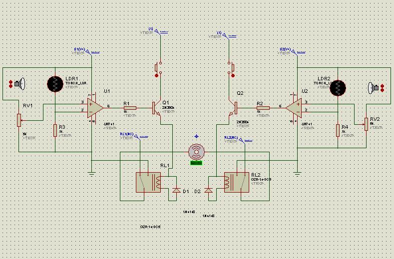

I've simulate your circuit....is it should look like this???
Correct me if I'm wrong because I've run the simulation and nothing happened...huhu

you are really close in your design, the only mistake you made is the limit switches, change them to PBNC and it should work fine.

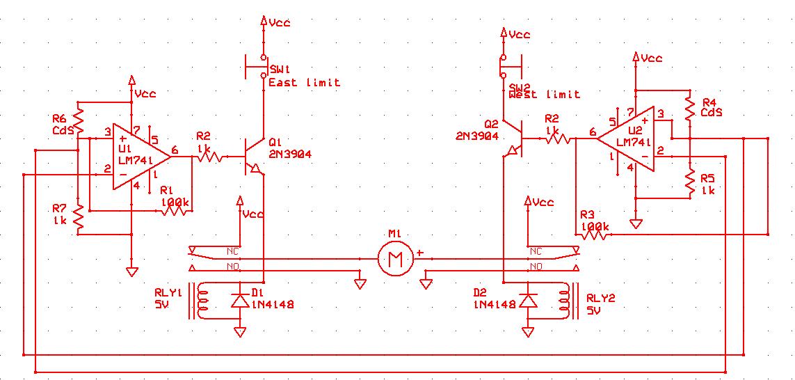

true there is nothing wrong with using a stepper motor, but for something this simple then you don't necessarily need to use the stepper, you can get away with using a regular motor and op-amp. as long as you use a gear ratio to slow the motors speed, normally the sun does not move fast enough for either a 741 or a CdS to respond to it appropriately. hence the gear ratio to slow the speed so that when the motor is activated then the circuit has time to respond to the change in light. you could also use a circuit like this:

The stepper is simple. Who says you need comparators and relays? The stepper is inexpensive, requries no gearing, has pleanty of torque and can position the apparatus very accurately, is simple, and as I've pointed out, can provide a certain amount of damping if done properly. Overall, the stepper solution turns out to be as simple and more accurate, considering the total system. Further, it would be easier to stabilize the system if using the stepper. It's a very cleaver design, once you grasp the details.

i don't know why your against using an op-amp. even a 741, i always use a 741 in my circuits before i try a different op-amp, unless a different op-amp is immediately required. if you use an op-amp then you can replace the 741 with a quad op-amp and he can make a north south function as well, if he doesn't want to use the relays, then he can use transistors and make the circuit more sensitive to the light.
Circuit
Resistors R7 and R5 should be as close to the CdS' standard resistance value (what it was advertised as) as possible.

Thanks dragon...I've simulate your circuit and it work...but, I still don't get the exact switch you mention before..the motor run but never stops...what kind of switch is it???
