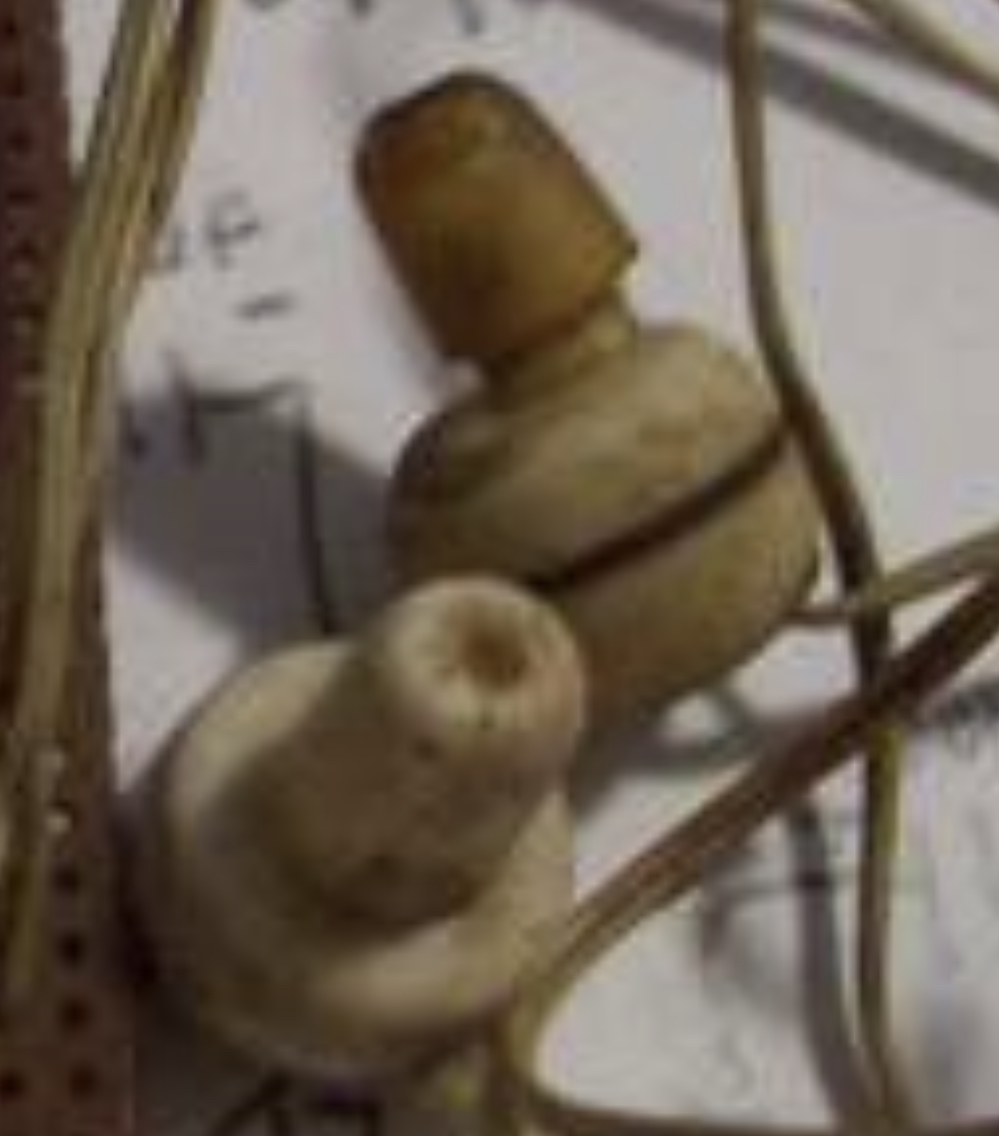

The earphones you are using are old-school piezo crystal earphones. Much higher resistance than 32 ohms. Also, the audio is not very good compared to modern earphones.
Also, zooming into your photo of the earphones almost made me gag. You might want to talk to your doctor about an ear infection.
I hid the photo in a spoiler so people know to look at their own risk.
Those ear phones have not been used in 20 or 30 years they look to gross to use. I would no be surprised if the cats have pooped or peed on them. My 20 new phone jacks came in the mail today now I can plug in new ear phones. First I need a new improved circuit that works. I think your right the TL071 is not much of an amplifier. I have a circuit in a 40 year old book that uses TL083 with LM386 but datasheet says gain = 10
