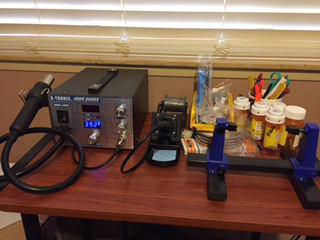

Well, I got my station yesterday, and now I will share my first impressions. First thing I thought when I open the box was "I'm gonna need a bigger bench". The unit is quite a consumer of real-estate. See image:
Looking at the photo, I guess it is not that much. Anyways, I am not usually one for reading instructions but I did this time. There was a warning slip that came with the solder station.

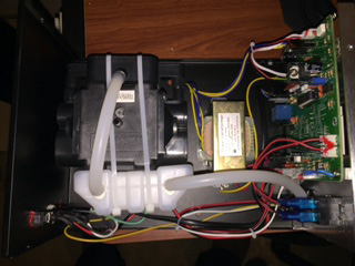

I read "Please Remove" the 3 "Silver" Pump Securing Screws which are located on the bottom of the unit. So I turn the unit on its side and sure enough I found 3 silver screws, and proceeded to remove them. As I loosened the third screw, I heard a plunk, and my thought was Oops! Oh crap, well not to let my new toy end up broken I removed the top panel, and sure enough, I had also removed not only the pump, but a power transformer. I looked around and I did not see any damage, so I just put the thing back together. Took a photo of the inside since I already had it open.
Looking back now, I think the warning label should have said, remove the #3 silver screw, doah :). Anyways looks like there is a microcontroller in this thing.

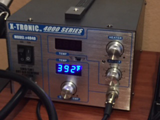

I put the unit back together and powered it up, solder iron only. Heated up quick and nicely, but as I was in the middle of another task, I thought I would do some actual soldering later.
So all in all, first impression are that this thing is solid and well built, the chassis construction was made with durable tough chassis and the Blue LED display looked purrty:).
Oh I almost left out the important part. I did measure the resistance of the heating element. There were 4 wires, two clear insulated wires and two colored wires. The ohmic value of the two color wires were 1.1 ohm, and the other pair was 14.8 ohm. The 14.8 ohm made sense but the other pair did not, to me anyways. Thats it for now. Oh a nifty magnifiying glass/lamp came with the unit, but it got set aside until I get a bigger bench top:)

One of my heating elements measures 15.5 ohms. At 24v that comes out to 37 watts.
The lower reading set is a K type thermocouple. This can be verified by heating up the iron with a power supply and measuring the output of the other two wires. I did all these tests when i first got the unit to find out how it worked.
Internally, they use a triac to regulate the power to the tip. The triac turns on and off in a very very slow PWM mode. Like on for one second, off for one second, like that. When it heats up from dead cold the triac stays on for a longer time until the tip comes up to temperature. The current to the tip is actually AC not DC. The AC is supplied from the transformer inside which may be a 26vac unit. The current rating will be limited which limits the tip power.
The type of thermocouple as well as the power of the element limits the type of tip that can be used with these stations, but they seem to be widely available, both the elements and the entire handle with element already installed.
The other type of temperature sensor commonly used is the temperature dependent resistive type, but that measures a higher resistance like maybe 10 ohms (cant remember exactly offhand). The resistance changers as the tip heats up, unlike the thermocouple type where the output voltage changes when the tip heats up (little by little).
It would not be very hard to make a controller for either type though, so if we wanted to move to a higher rated iron we could make our own controller and driver using a 24v power source and small, cheap control circuit (very simple design).
The heat gun is more complicated because it needs that air pump, but then again the heat rating for that is much higher possibly 600 watts.

Well it turns out, only one screw was used to secure the pump, the other two were holding the transformer in place. Mine too had red goop around the screw.
