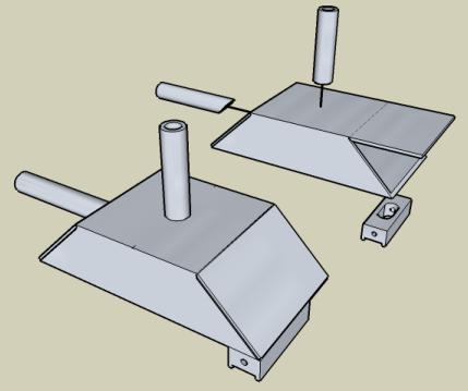

i used to weld aluminium in my old job. one of the accesories we
made for model aircraft was a manifold to fit inside a radial cowl.
the body was 1"x2"x4" 2mm wall thickness, 2off 3/8" tubes 2mm
wall thickness (modeller to chop off the one they dont want)
and a manifold block milled and drill from 5/8"x1/2"x1.5". watching
for the sheen change on the ali as it was heated was quite a clue
but i also found the flux paste we used would dry as it the metal
was heated then very close to being ready for the welding it would
go liquid again. great fun took about half aday to learn not to turn
them into a molten lump. lololol
Regards
Fenris
