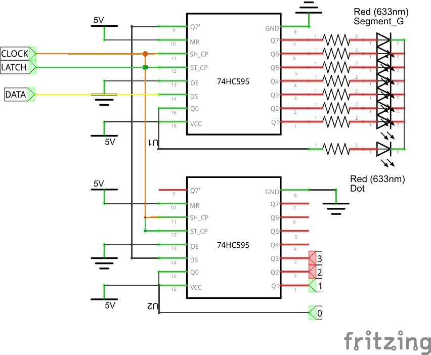

(Solved)Again problem with matrix, this time 8x32
I am worried though that you cant see scrolling, what about the binary values in the corner, they should be changing with time?
yes, they do blink & change thankfully. I played bit and managed to make scrolling counter with millis(), so RTC should be indeed possible!
I MADE IT! Scrolling DD/MM/YY HH:MM:SS
I'll upload code & video in a few! :)
and code(needs bit refining, seconds won't update while scrolling, I know it should be possible as I made 9999 seconds counter that scrolled and updated as scrolling) And for some reason couldn't place all stuff in one loop(), now date & time are separate, but it works. And thanks a LOW for you guys for help!!! :)

Thanks doggy, thought so. That code just makes life SO much easier because it can show pretty much any data and so It's perfect for my car computer project, but I'll probadly need to make 14 segment version too to show menu system better (alphanumeric characters). I'll try it first myself, font map I got already rewritten for 7 segment, even array size.
this I've gotten thus far, no sensible yet and can't find reason why:
C:
#include "FontMap7Segment.h"
int dataPin = 2; // ic: 14, ser_in Define which pins will be used for the Shift Register control
int latchPin = 3; // ic:12 silkscreen numbers!
int clockPin = 4;
unsigned char displayPointer = 0; // for interrupt use...
unsigned char buffer1[4]; // buffer for screen, was 32 for matrix (4x8=32 and each character is built from 8x8 block, due 8x8 matrix) but for 7 segments, each character is 1x8 and screen is 4 digits so buffers are 4
unsigned char backbuffer[4]; // Spare screen for drawing on
unsigned char power[4] = {1, 2, 4, 8}; //B00000001,B00000010,B00000100,B00001000 for digits
// was: unsigned char power[8] = {128, 64, 32, 16, 8, 4, 2, 1};
ISR(TIMER1_COMPA_vect) // timer compare interrupt service routine, called every now and then, outside of loop
  if (TIFR2) // Make sure its the timer interrupt.

oh ya , we also need to change the setcolumn, setdata and the isr that calls them, those were the code for shift register specifically for your previous config,
how do you have 7seg hooked up , is it on shift register too?
Oops, forgot to mention how circuit is. So yeah, I still use shift registers as they are "easy". Two registers chained in series, first controls anodes and latter columns/digits via darligton array. First is wired to segments as q0->dot, q7->g, and that's why first, q0 is "un-used" (I don't have decimal point in use at any character). The latter has digits covered, as so; B00000001=digit 0 on, B00000010=digit 2 on etc.
So baicly quite same setup as in matrix, I'll toss schematic in A few (need to draw it first)
This way:
in this one you no longer need setcolumn routine, instead just delete setcolumn, and change setdata sub so it bumps out one numeric value after another..
also your cathodes can go straight to ground, with the 7 seg we no longer need to call them individually
Umm, how come cathodes straigth to ground? Aren't then all digits be on all the time and digits show same value?
This display I use:
on a glance , i noticed that in set data a number got changed to 16, change it back to 128, 128 represents that we are shifting out the msb.
same with the power variable, it should remain 128
also in charput, this equation needs to be changed: disp = font[x1 + (ch * 8)]; it is no longer *8, and i think everything with x1 can be removed,
also try debugging with pixel and charput commands before using strput, since strput relies on using charput, and charput relies on pixel and fontmap
also in setdata, you may need to flip polarity at cathode, by flipping the top line here with the bottom line (maybe):
