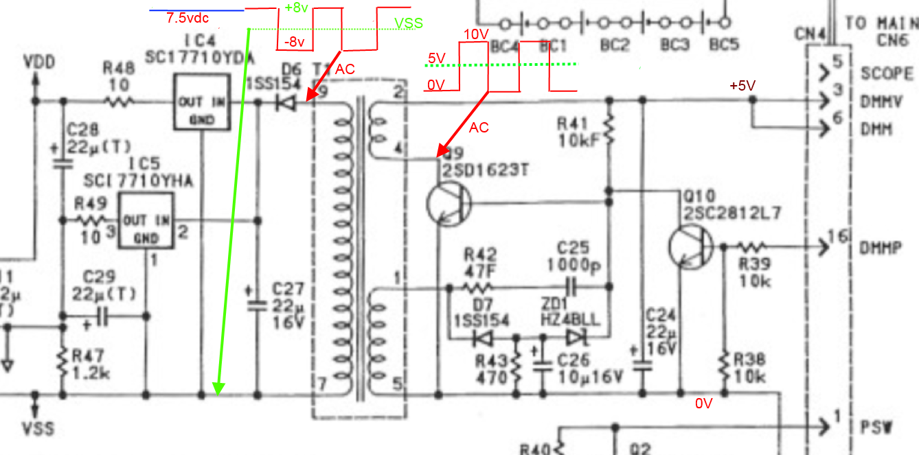

T1 here on the photo. DMMV takes 5v. DMMP on high 5v disables the circuit DMMP on low enables Q9 and takes 5v DC to the transformer. That should output something in similar range.
Maybe I should call it a DC/DC converter instead of transformer?
Q9 is an oscillator.
T1 pin 2 Voltage = DMMV (maybe 5V)
T1 pin 4 Voltage = AC voltage, when Q9 is on the voltage is about 0V, When Q9 is off the voltage is about twice DMM.
T1 Pin 9 Voltage = AC voltage, About +/- 8V.
Voltage on left side of D6 = DC at about 7.5V.
When T1 was on the circuit. I was getting:
- 0v on the left side of D6
- DMMV +5v (as it comes from the main board)
- DMMP low = 0v high = +5v
- IC4 (REG LINEAR 3V 250MA SOT89-3) output was 0v
- IC5 (REG LINEAR 1.5V 200MA SOT89-3) output was 0v
- Q9 & Q10 have been tested and both read 0.6v on the right direction
What you suggest? Is there a way to test T1 off circuit?

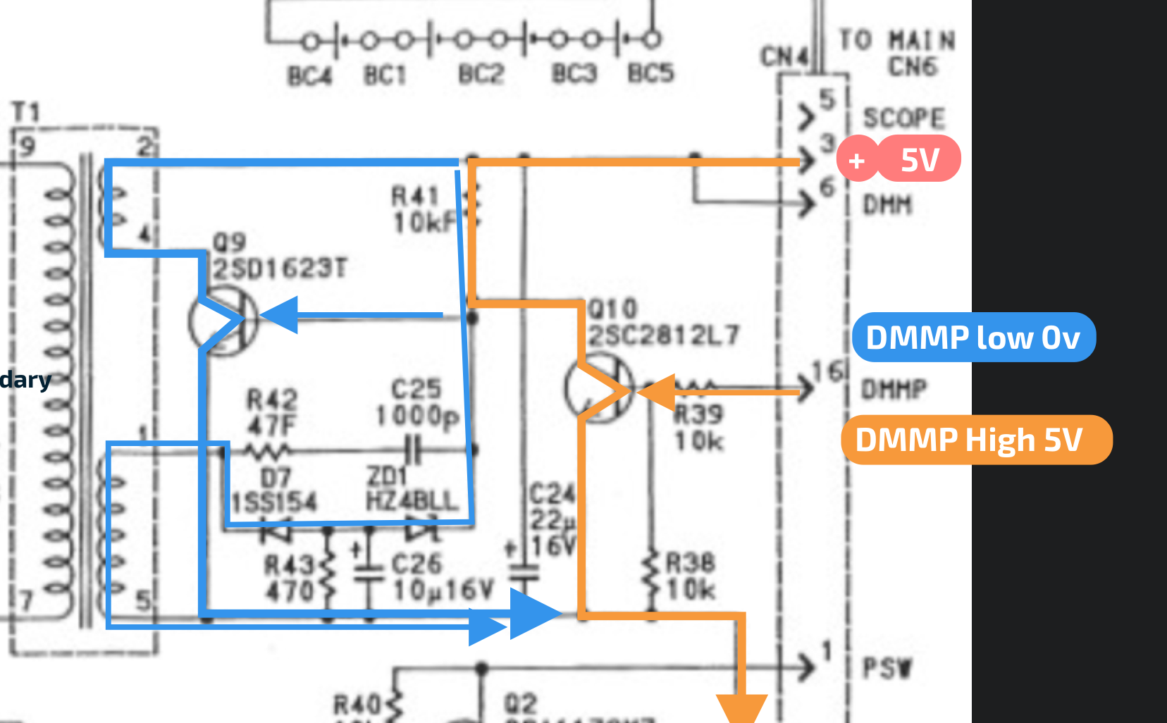

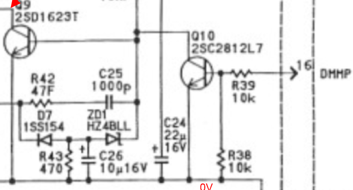

If "DMMP" is high (above 1.5V) then Q10 is on. If Q10 is on then Q9 is forced off. This will stop the oscillation and stop any power from getting to D6 and IC4 and IC5. Please look at DMMP (16) and see if it is near zero or above 1.5V.
Basically what you are saying is represented by the image bellow right?
When I tested it I got the following which seems right. DMM function of the scope is enabled the DMMP goes low. DMM function is disabled the DMMP goes high.

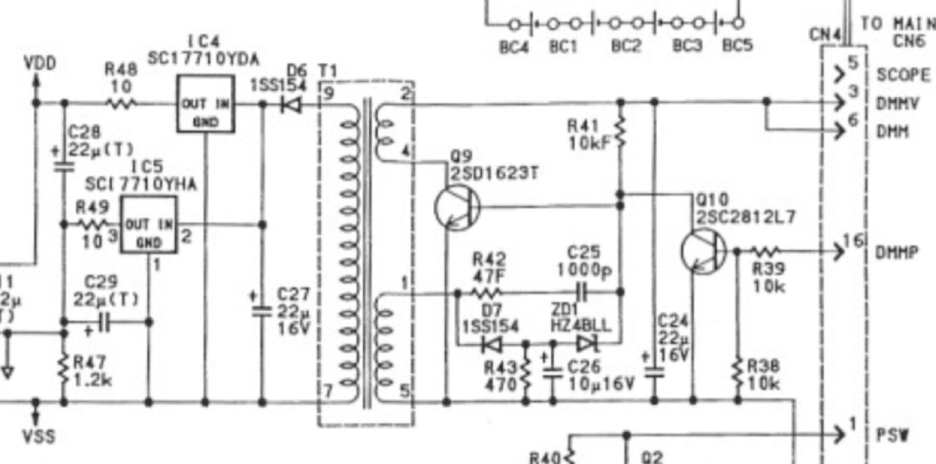

At the photo of thread #11 the blue line shows the oscillator for the DC/DC Converter.
It's hard to find problems here without an oscilloscope.
Obvious it doesn't oscillate, rather DMMP = 0V.
The parts round diode D7 seems to be a load regulation.
When no oscilloscope is availible first thing i would do is check the components ( Resistors, Diodes, Transistors ) of the oscillator part.
Additional D6 and search for shortings to GND behind D6.
All this can be done with an resistor meter an and diode tester ( diode test of multimeter ).
How old is this thing?
The electrolytic capacitators are often the problem in older switching power supplies.
But to test them, You may have an capacitance meter.
C24, C26, C27 could be faulty.
One more thing: Are you able to disconnect the load (at the outputs of IC4 and IC5) before testing the circuit? A short-circuit on the output might stop the circuit from oscillating.
Come to that, you should check from the junction of D6 and C27 to ground, to make sure there is not a short. That would mean a short in either D6, C27 or IC4, IC5, which would stop the circuit from working.
