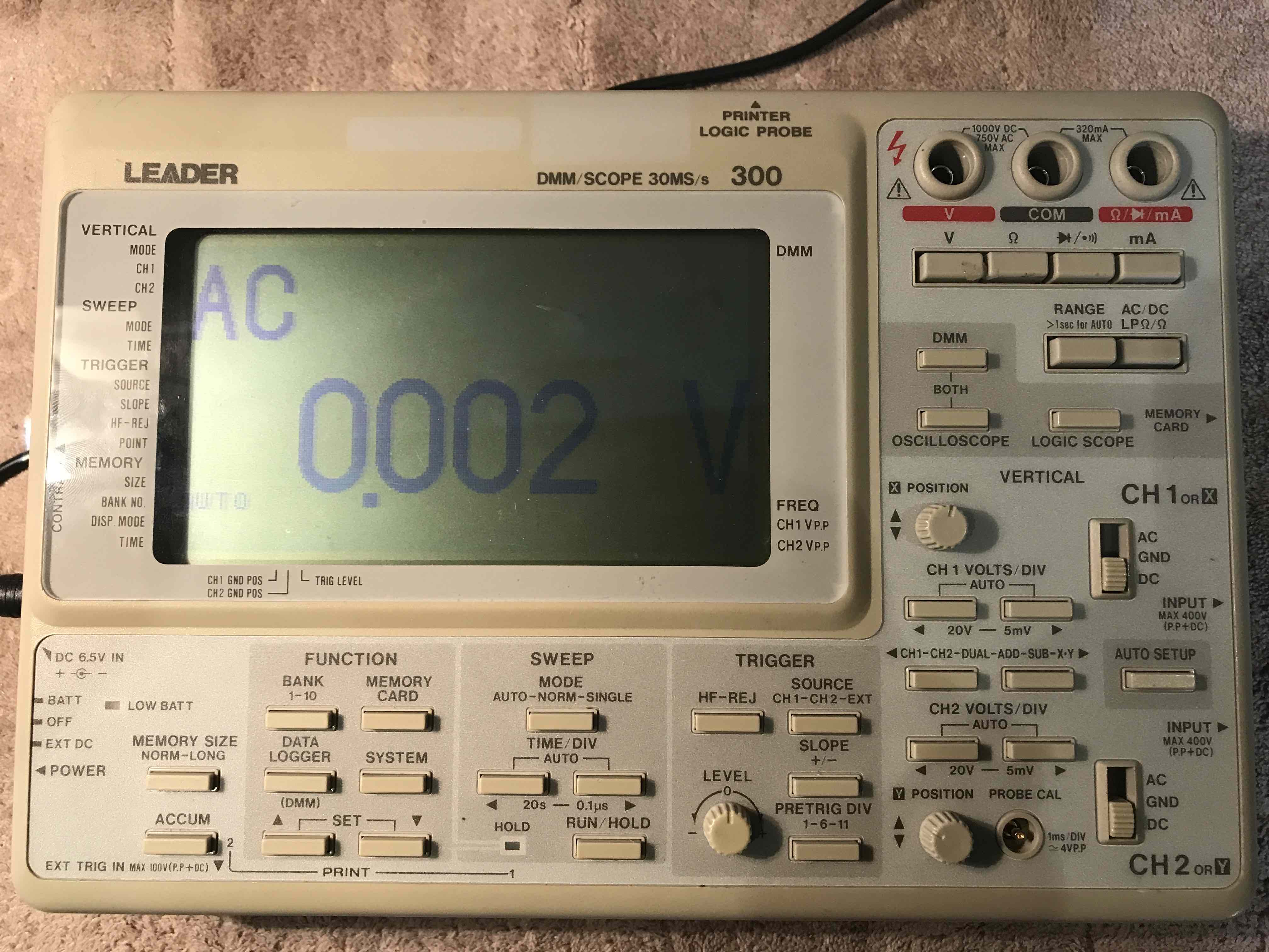

It is fixed now. Q10 was faulty and the transformer was fine.
The diode after the secondary reads 6vdc.
Thanks to all of you who toke the time and patience to provide guidance and ideas.
