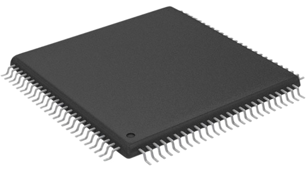

Question 1:
Is there any way to convert QFP package IC into a DIP package for use on breadboard? I was thinking of experimenting with PIC32MZ2048EFM144 since it has an FPU. Actually I need to use an MCU with integrated FPU and PIC32 is the only one I could find.
Look here (Originally from post #15):
https://www.proto-advantage.com/store/product_info.php?products_id=3600003
I've been meaning to pick up some of these. :)

The pin count for PIC32MZ2048EFM144 is 144 and this DIP converter has only 52 pins so it won't work.
