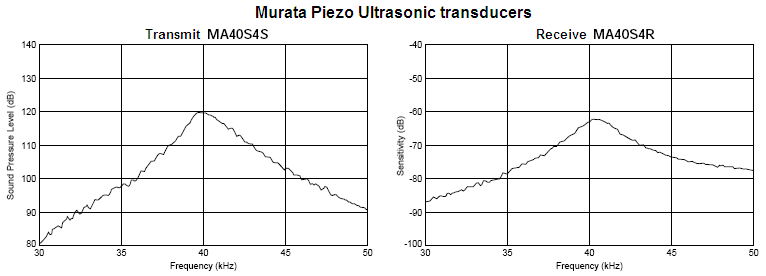

A typical ultrasonic transducer is the Murata MA40S4. It works in air and has a range of 1m to 2m.
It resonates so it has a narrow bandwidth.

Rapid don't sell them but the catalogue (see page 47) on their site lists a 200kHz underwater transducer with a maximum 50W power input and a bandwidth of 25kHz.
I think you need to go up in frequency, 40kHz is far too low, 200kHz is perfect.
