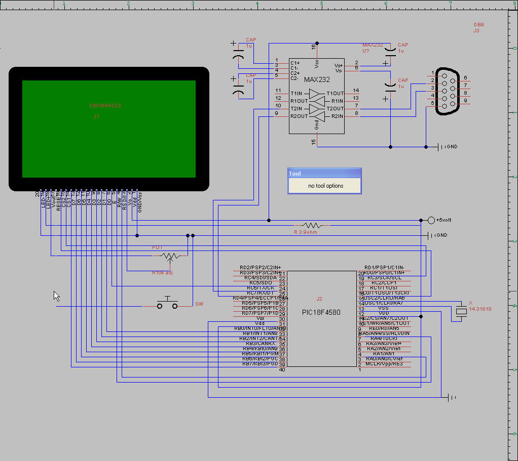

So this is how far I have gotten. Does it even look right ?
Does this look right so far? I dont want to draw to much. yet and not even be close. I basically want to type things on the LCD from the computer. or have it show things about the computer. Does not matter.

That looks correct (except for LCD reset floating) however, you have chosen a graphic LCD. Graphic LCDs are notoriously hard to get working especially as a first project. I would advise switching to a text LCD (HD44780 based) such as this 4*20 display.
Edit, if you fill in your location other posters may be able to advise where to obtain things locally.
Well I have the LCD now.. and well. its what I have to work with.. I have Color LCDs out of cell phones. but none I think I can get to work at moment. When I check the Design rules im getting alot of errors. Im useing tinycad.. Anyway to Auto fix this ?
I would really, really second that emotion that you not try to program a graphic LCD your first time out of the gate. Text LCDs aren't very expensive, so it ain't worth the headaches, even if you have a pile of free ones available.
Cut your teeth on a text output device first. Then try programming graphics. Otherwise, you'll just drive yourself nuts.
Have a read of the later pages of this thread for an idea of the problems people have with graphic displays. There is working code that I posted about half way through the thread but it only works with certain makes. All the manufacturers seem to make them slightly different which is why it's so difficult to get them working.

Well, I dont have the luxury of spending $ 25-30 bucks on a lcd..I do have the model number and found information on the GLCD that I have. I was hoping that's all I needed when it came time to work on the source code.
IM not looking to learn everything there is to PIC microchips. IM trying to just get as good an understanding of how all this works. My Plans are to make things that interest me not repair electronics just make a few gizmos...I have some health issues IM dealing with.. and Learning About IC chips sitting here at desk is something I can do and not be standing up..I have a lot more time on my hands then money.... And reading greek for hrs and hrs tends to get me confused sometimes.. Now if someone is willing to help me at least get this drawing done and answer some questions about tinycad that would be great.. If nobody is willing then fine...
SNIP.. Now if someone is willing to help me at least get this drawing done and answer some questions about tinycad that would be great.. If nobody is willing then fine...
People are willing to help you............by offering the best route to getting you started, without using obscure devices which have almost no information available.
You had the suggestion to get a HD44780 compatible LCD module, offered by myself, in your other thread https://www.electro-tech-online.com/threads/m6117b-a1-mini-board-help.119570/ and use the tried and tested PIC tutorials made by Nigel Goodwin.
The same advice is being offered within this thread, by other members with much more years of experience. You should appreciate why...
If you give us your location, we may be able to find a source for one of these inexpensive HD44780 compatible LCD modules for you. There may even be a member close by willing to lend you a hand, or point you to a store where they could be had for minimal cost.
As already stated, trying to use the GLCD you have, as a beginner and due to the extremely limited information available for it, is more likely to lead to headaches and frustration, rather than progress.
I do understand you trying to give me the best advice you know you can.
I would rather fail 999 times out of 1000 then to succeed the first time out.
Now as far as hands on help. That would be great. I live in New Smyrna Beach Florida. That's south of DAYTONA Beach about 10 miles. I guess I should update profile.
I have a lot of patients... I do not give up easy
Thanks for offering Your best advice you know how. But no thanks.
I will figure this out.
I look at it this way. It will take me weeks to scrounge up money to buy a LCD. Then order.. Then if its anything like my last experience it will take months to get... I ordered chips from mouser... post office lost them... Mouser was nice and sent out replacements.. told me i should use fedx... ofcourse one of the big chips pic16f1937 had pins laid all the way over.
My luck is not good.. never has been...And when it comes to doing with what you have on hand... I make McGyver look bad at times.. Yes hes one of my heros :} lol
As you're stuck with the GLCD then let's try and get something working. Things I would change/add to your diagram,
Add a pullup to the GLCD reset line. Also think about connecting it to a pic pin so it can be reset in software.
Add the required capacitors to the crystal. If these aren't available (yet) then you can use the internal oscillator.
Add decoupling capacitors to both chips.
Depending on power supply availability, you may want to add a regulator and associated capacitors.
On a spare pin (or 2/3) add resistors and LEDs that can be lit/flashed for debugging purposes.
Think about adding an ICSP socket for programming purposes. This would require freeing up port B, so switch to port D and put ALL control lines on one port (A maybe).
That's all I can think of for now.
Edit, forgot to add, data sheet doesn't mention chip set but I think (hope) it's the KS0107/8. The code above doesn't help much as it doesn't read the display so not sure if a dummy read is needed or not.
Yep its a KS0107B according to midas web site (half way down)..
There are plenty of examples on the web for this... I have C drivers for this, but non in assembly (probably wouldn't take to long to convert )
I'm not sure what language the OP is planning to use. I have C code and Assembly but the asm is for a 16F886.
Thanks for the help Guys... I was planning on using C as that seams to be very common. Of course I dont know how to Program.. What IM hoping is to just get the screen to say... Hello World From HommerSimpson.
Then I can backtrack.. Look at what I built. Look at the code that was used.. and with any luck it will help me grasp what is going on.
I did do the mplab courses and well I do grasp some of it.
I have some issues reading and staying focused on what IM reading. Kinda like Reading a history book. And then when done, asked Questions on what I just read. Cant Answer.. But I can tell you what motor I just rebuilt in my Head while I was Reading LOL... ( my mind wanders. touch of ADHD I guess).
Can I upload the tinycad file and have someone fix what I have wrong then Maybe a simple explanation as to what I was doing wrong or right...?
