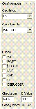

Setting during Programming???

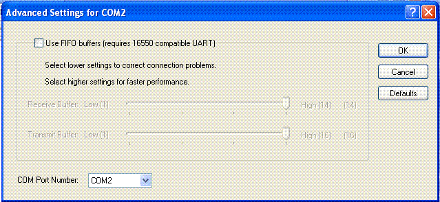

ICDWarn0034: Please ensure that your system's serial FIFO buffers are disabled.

What should be the setting during programming of PIC16F877A with "ICD2_Bootloader_A"... Picture Below.
My Fifos are also OFF

You mean during the feeding of Firmware(ICD2_Bootloader_A.hex) into PIC16F877A???
when programming the "target" chip ,
there are configuration bits (in the target chip memory) that need to be set
depending on the type of osillator the Target will use , you eithe set the config bits, to HS high speed , internal , or a few other options.
LVP is another option set in the config bits.
the config bits are set by either MPLAB or in the assembly program itself.
i forget the syntax of the assembly code for the config bits , BUT each target chip has its own , config bits , and they are different , mostly.
What is your target chip?
