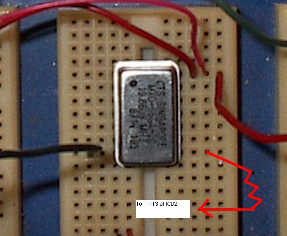

i too was getting #21 error
untill i got my ICD2 oscillator working.
have you got another clock source available?
i used a 100 ohm resistor , neither part was damaged.
and i touched pin 13 of the F877 on the ICD2 board , and clicked connect at the same time , and it worked.
EDIT of course the two grounds have to be connected also

Ayne said:
In my view crystal should be little above from PCB surface.... I mean crystal not touched with PCB surface....
Quite right, not too snug as most crystals have metal bottoms that may short out against the pads on the PCB. Some series cut crystals may overdrive the PIC, I'll look into ones that work and post a digikey part number in the assembly manual.
