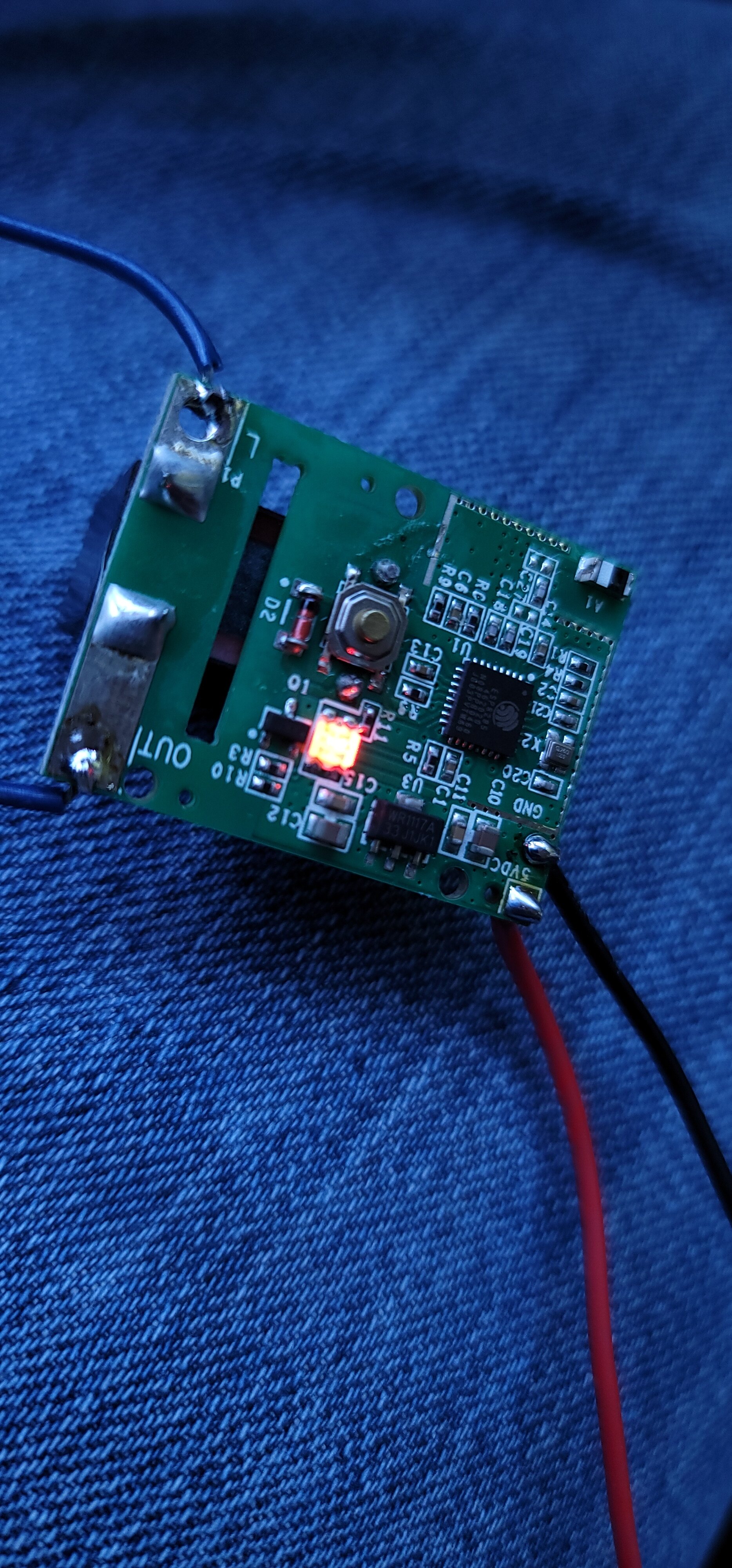

So I got a sonoff smart WiFi switch (RE5V1EC) to safely initiate all my potentially lethal chemical ignitions (methane balloons, chlorate powered rockets, enclosed butane vapors and all other cheap pyrotechnics you can imagine).
I quickly realized that:
1- it's a headache configuring this sonoff switch and successfully connecting it to my phone.
2- it was built for this type of rare use, but for a permanently powered type scenarios (smart home and all).
Here I discuss the first issue. After I was able to put the device in connection mode (after much frustration and googling), I was finally able to connect to it as a WiFi router.
Now comes the puzzling part. It's about the app eWeLink.
I select Quick Pairing (because the device supports eWeLink) and I get this:
This takes me to my phone settings and no matter what I click or select, it never successfully finds an "access point for device sharing" (whatever that means).
Any help in this regard will be greatly appreciated. Thanks.

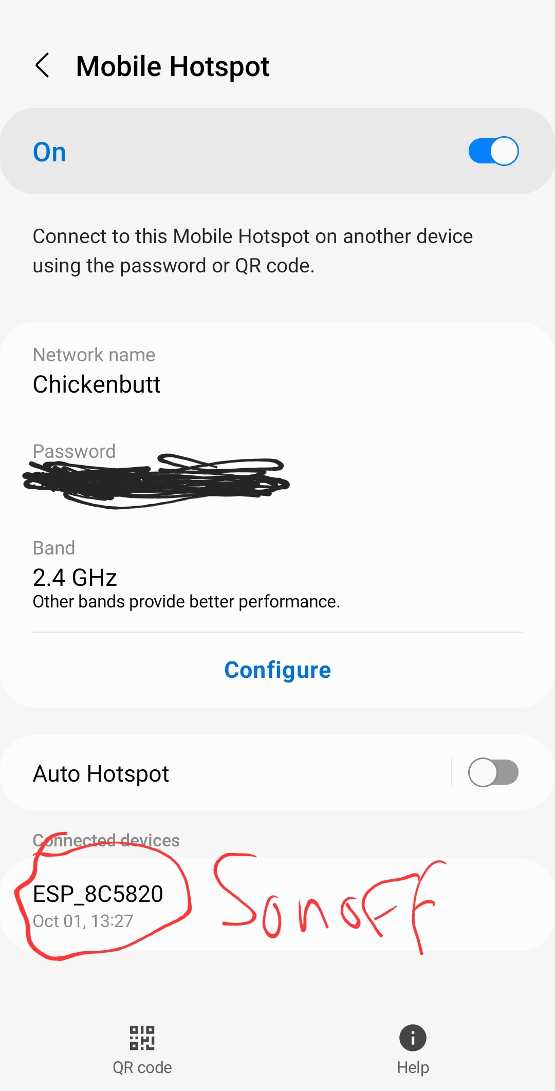

1. To initially pair a Sonoff device, your phone must be logged into a wifi network which you have the password and SSID for. Enter this info into Ewelink, and pair the Sonoff device.
2. After that, from any location you (and the Sonoff) are at, enable your phone hotspot with the same SSID and password. After half a minute to let the Sonoff connect, you can control it from your phone.
I'm in the car a mile from home, well out of home wifi range. The phone's hotspot is configured as stated above, so it is the Sonoff's connection. The Sonoff responds to commands as expected.
My hotspot only functions when I have a cell signal, so you must have a cell signal for this scheme to work. But when you configure the Sonoff on a "real" wifi network, it works great and exactly as expected on a mobile hotspot.

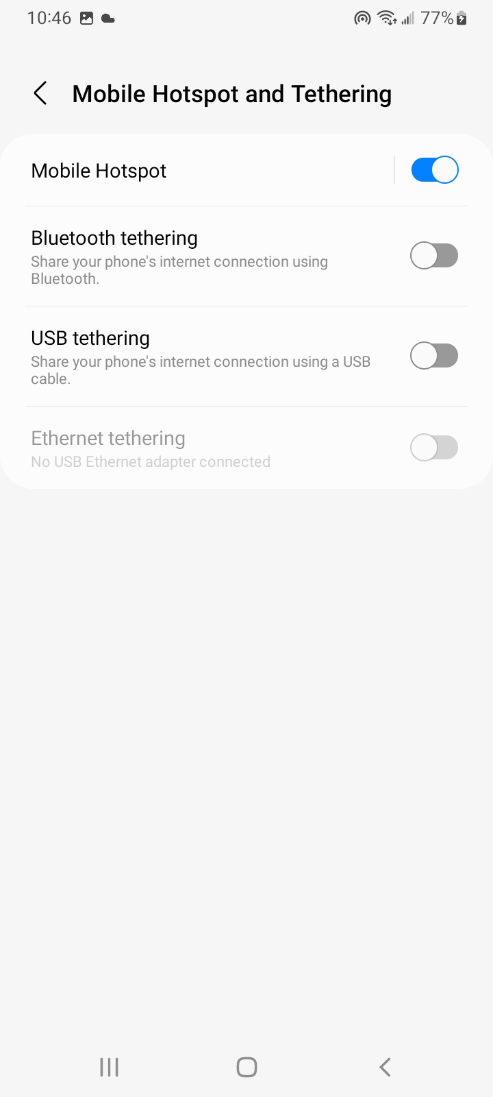

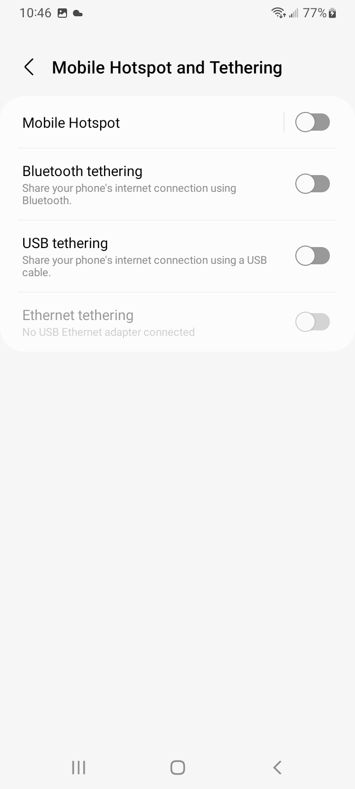

I go into settings / connections and choose Mobile Hotspot and Tethering. When I tap Mobile Hotspot I get a warning "to use mobile hotspot WiFi needs to be turned off. The turn Off option is right there. So OK I enable hotspot and that turns off WiFi. Now the phone is a hotspot and works just fine as a hotspot. My computer, my wife's computer and my wife's cell all can see it and use it. but I cant use it for anything other than a hotspot, I can't turn and Off with it. Just won't work on my phone.
All here nor there since we have no idea what the thread starter is doing? In your last pictorial the final image shows mobile hotspot off.
Ron
Tethering is EXACTLY what you DON'T want. That turns off the wifi access point that the phone creates.
A hotspot, at least on any phone within a couple generations, sets up a wifi access point.
No, I get it about tethering and what you are saying. When I said "I go into settings / connections and choose Mobile Hotspot and Tethering". I was describing the opening screen. Mobile Hotspot and Tethering not saying to use tethering.

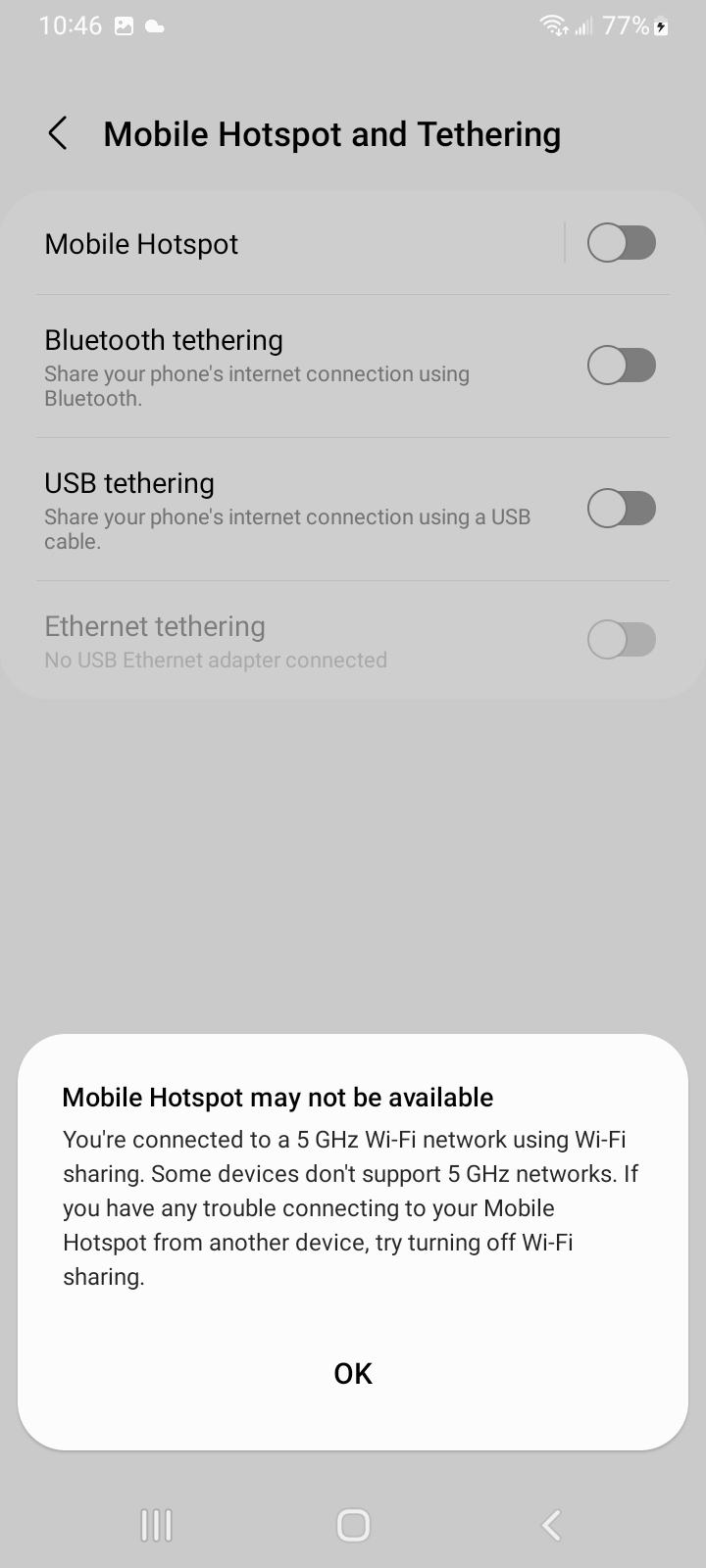

So next I choose Mobile Hotspot and get the following with the notation about WiFi.
At this point just click OK and the mobile hotspot is enabled Note the mention of WiFi Sharing and the links I provided earlier. So anyway just click OK and you have a hotspot enabled.

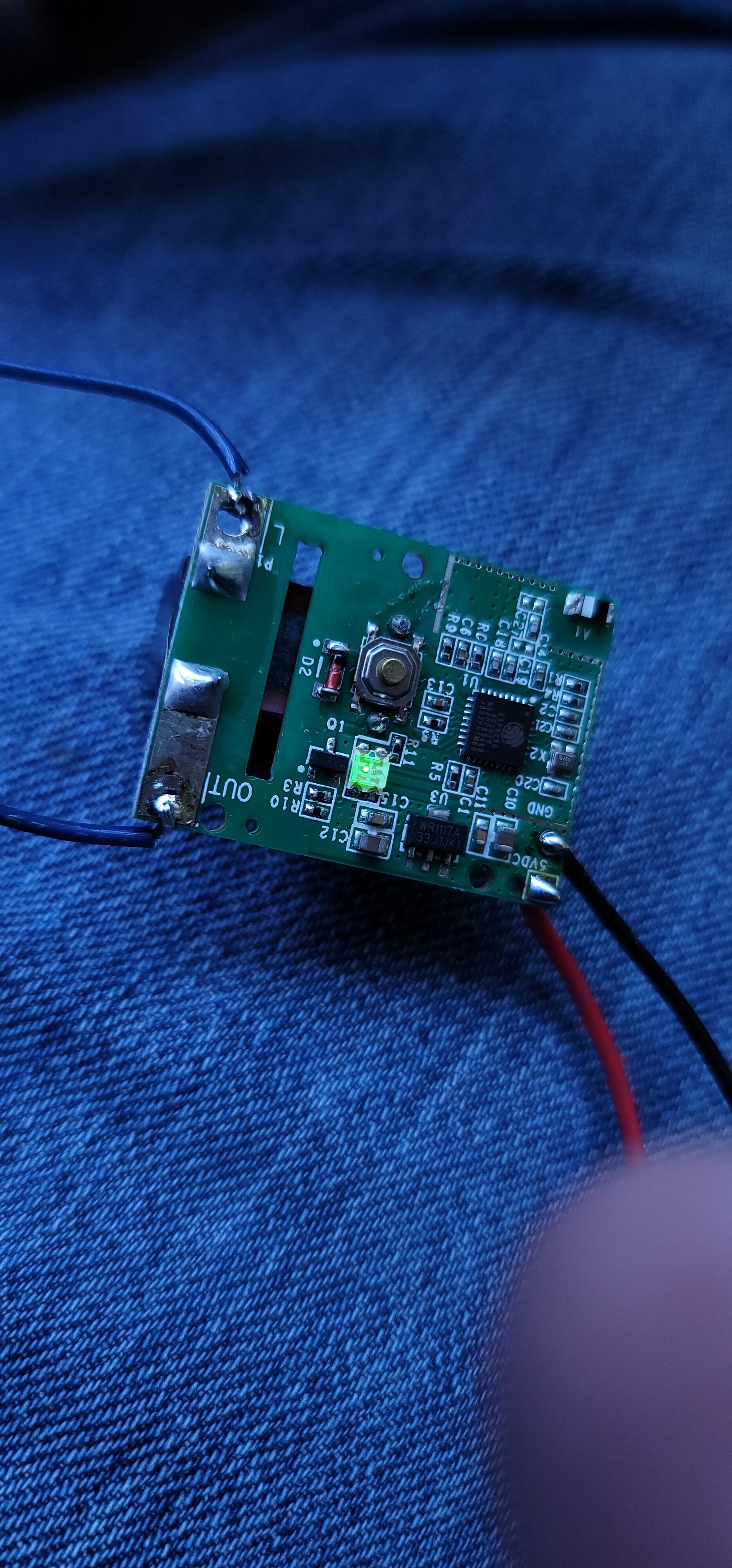

Ok. So. Update.
A friend from a nearby town (I live in a village) came by today and was surprised that I didn't know how to pair this sonoff with my phone (since it was I who had first recommended a sonoff to him when he had mentioned a couple months ago that he wanted to control one of his outdoor lights with his phone).
He took just about 1 minute and added the device to my ewelink, through my home WiFi.
Now I don't know whether I also need internet on my WiFi to be able to use this device or it will work offline too. But so far, everything seems to be working perfectly.
I still want to know how to control it directly (without the WiFi middleman) though. I don't want to carry my WiFi device outdoors with me ...

Sigh. Yes, it will work, if the phone can act as a hotspot and it's configured to the same SSID and password as the home network.
I really did test and verify this.

Ot you can do the exact same thing using the stock Sonoff firmware as I have shown, tested, demonstrated and proven already. The only limitation is the Sonoff must be set up on a home wifi network, and the phone's hotspot set to the same SSID and password.
