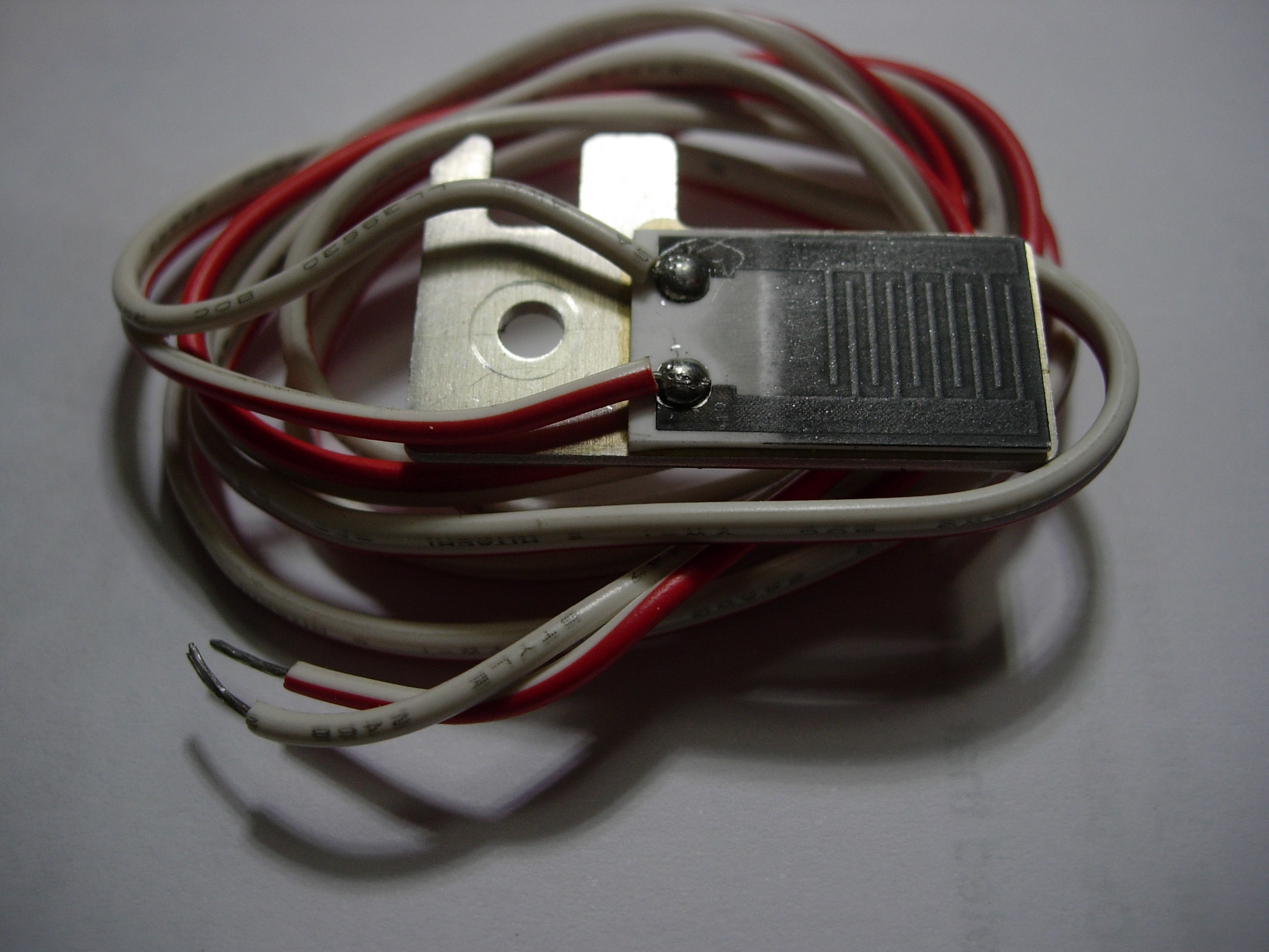

Basically it's a VCR type machine, with helical scanning - the moisture detection is normally done by a resistive element mounted on or near the head drum assembly.
This is what a Dew sensor looks like in a VCR. This particular one reads aprox 800, ohms dry & goes up in resistance with condensation to 4k ohms. With VCRs if there was moisture I used a hair dryer to dry out the mechanism.

This is what a Dew sensor looks like in a VCR. This particular one reads aprox 800, ohms dry & goes up in resistance with condensation to 4k ohms. With VCRs if there was moisture I used a hair dryer to dry out the mechanism.View attachment 87202
Thank you very much! That def gives me something to look for. So it sounds like I can check the sensor with an ohm meter? Is the resistance marked on the sensor? And can you tell me if this is a "dry" contact point? If it is I should be able to "jumper" out the circuit to at least troubleshoot if its causing me the problem? Thank you so very much for your knowledge and information....sounds like that is where I need to start!
