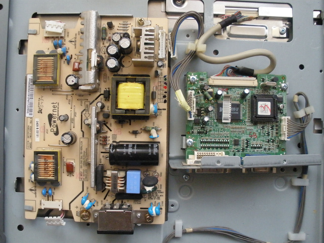

Anyone have experience or help troubleshooting this 6 years old -Freecycled- 17" Sony SDM-HS74 LCD ?
At first, when powered on, the symptons were: green power led on, raster with osd but only for 5 sec. or so, then shut off and led turns amber.
Now, as you can see here, when powered on, this info
is displayed and the green power led stays continuous on .

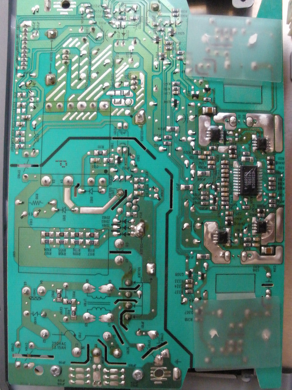

The board is LG 6871TPT285A model PWI7LS285A rev.A
The caps are:
Rubycon long life high ripple YXG
c202 470uF 25V
c203 470uF 25V
c205 1000uF 16V
c315 470uF 25V
c333 470uF 25V
sorry, don't have a esr meter
tested power/inverter board conector pins with a dt9205b multimeter:
13.78V at +13V
4.95V at +5V
could it be the microcontroller board ?

you have to replace some caps: 1000µF (2 or 4 can't remember) i have fixed one, this is now my main screen.

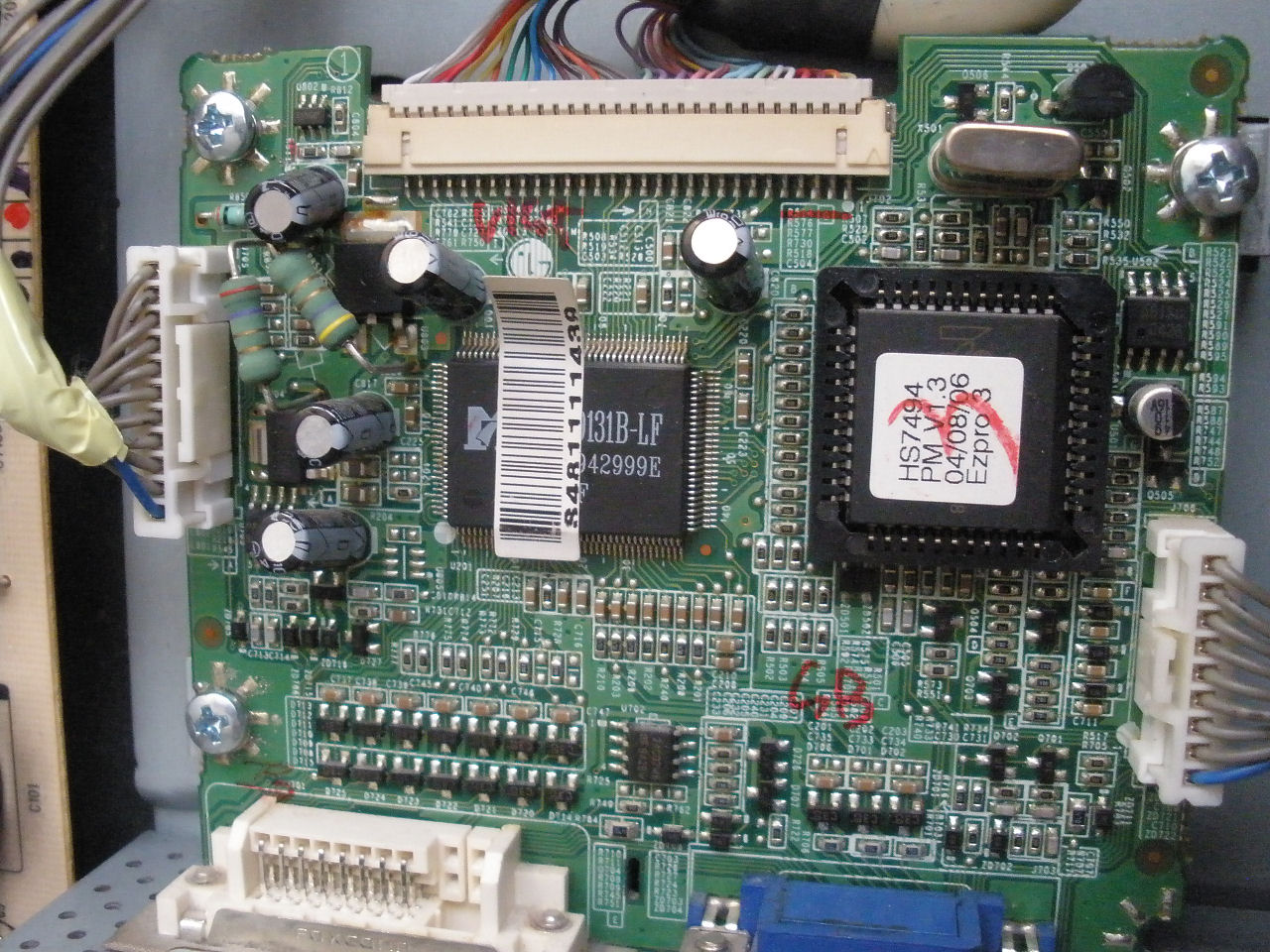

In the smaller mainboard the MST9131B LCD Controller (U201) POWER PINs: VDDP(3.3V)and VDDC(2.5V) are both low (1V).
Noticed small solder balls in the smaller mainboard left side (next to POWER/INVERTER board heat sinks), could also have dry solder joints at 3.3V and 2.5V regulators, I need to check them.
The electrolytic caps in the smaller mainboard are: RJ4 ELNA 16V 100UF.
as far as i can see on my screen is everything with screws.. Just test with other condensators it costs not a lot, max 5eur. for me it was the solution! i had sometimes image for over 2h, but also 2s and it powers down amber color. First you can try warm up the condensators if you're screen is working then you have to replace the condensator. when you set the contrast very low (if possible) then you will have an image for an longer time-period. you can also touch all the solders with iron of witch you think they are bad.. after warming up the condensators don't wait to long before powering up..
good luck!
