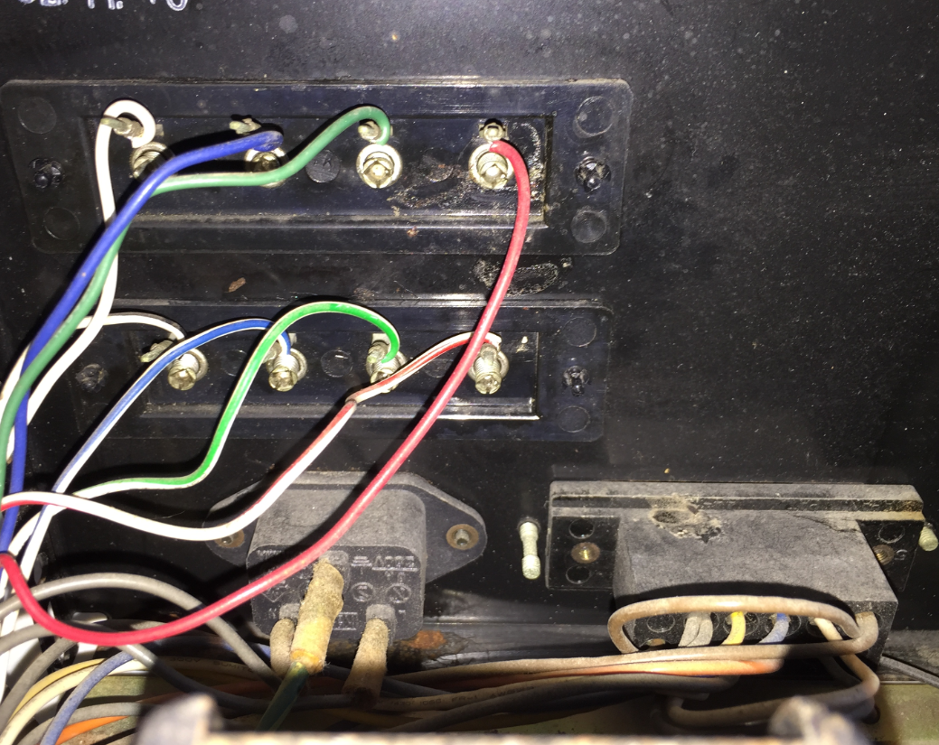

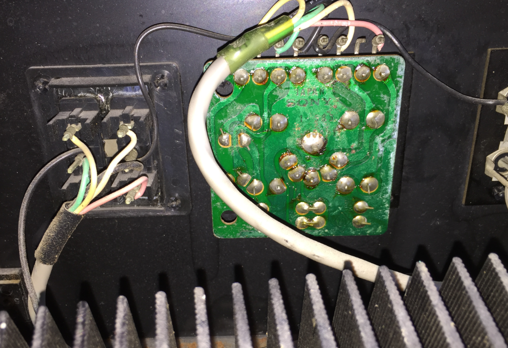

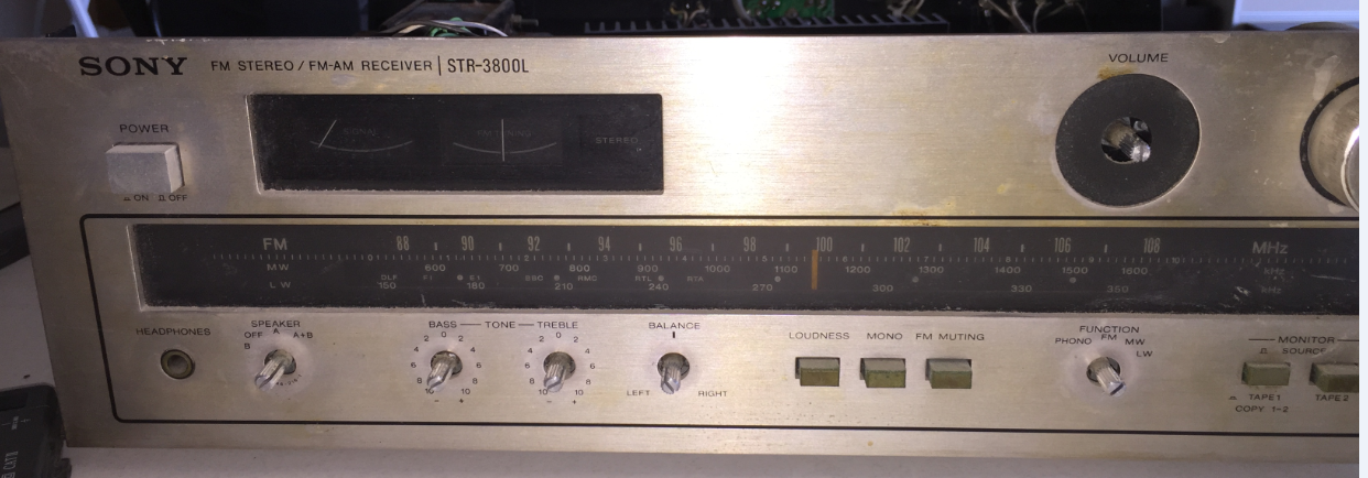

Any way, I got my hands on an old Sony AMP, that's not super impressive with stats, but I would really like to get it back into working condition.
When I've connected it to power, the bulb lid up and it seemed to work. As soon as I connected it to a speaker, it started producing very large amounts of noise, and with a kind of loop that makes its amplification larger over time (matter of secondes).

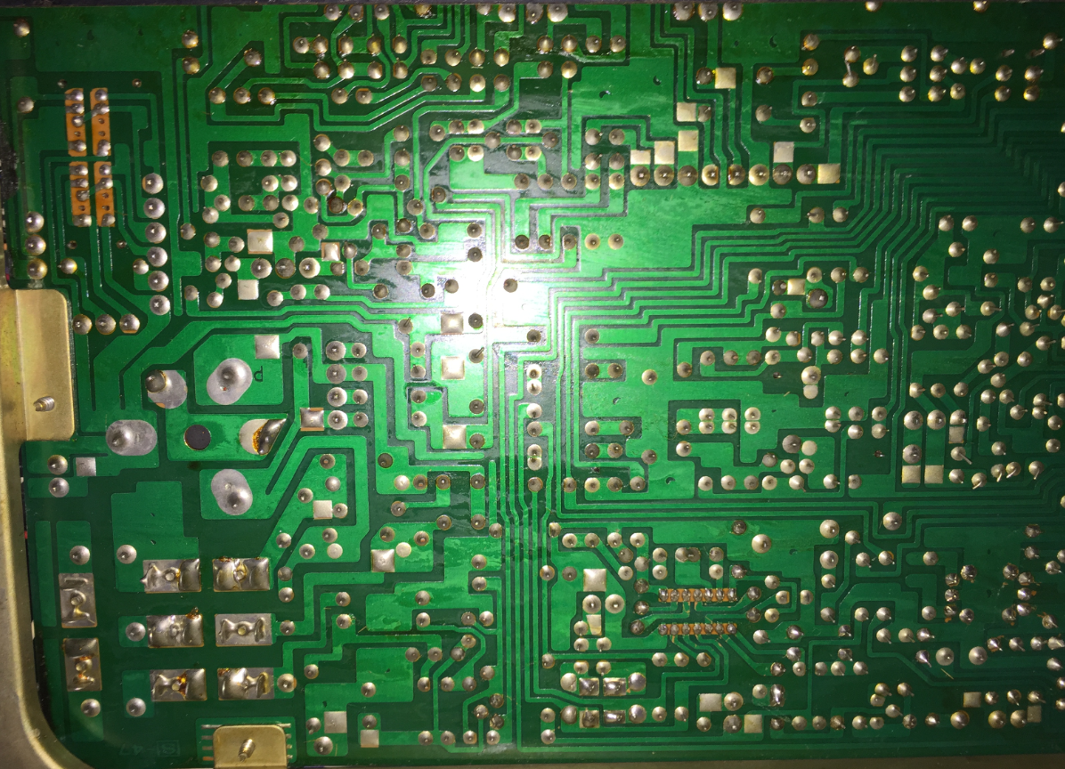

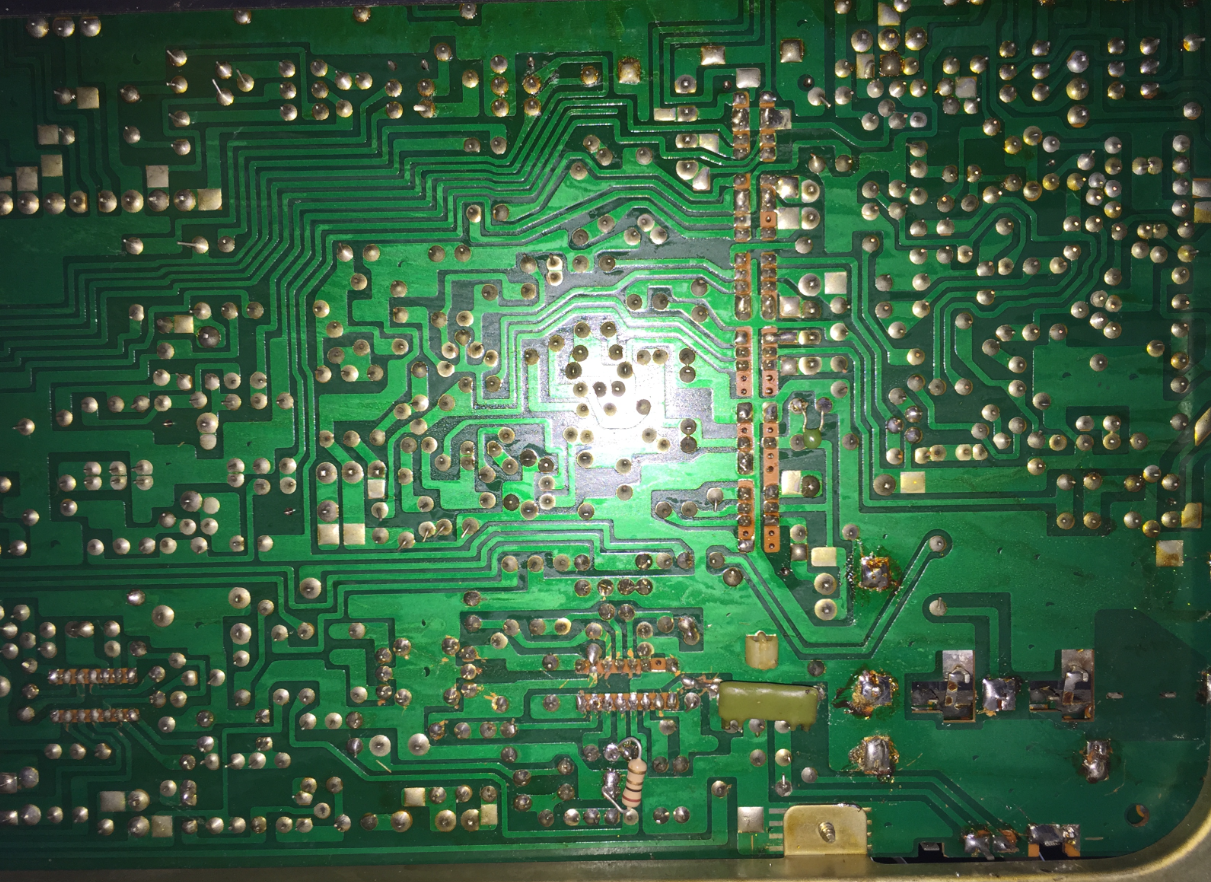

I'm a really big noob, so I've tried Googling some things. Some posts suggested checking the transistors, so I did. The NPN once read around 0.53V B-C, B-E and the PNP's read around 0.6V too. The resistance for all transistors from E-C was okay, well at least it gave a large resistance and not something that is striving for a zero value. I've tried checking the speakers connections, and I've found out that the black connection, the minus one, at the B speakers isn't connected together. Maybe it's just an old wire, but what it's really that, how do I diagnose the problems?
Therse a dual C filter cap, that means it's a cap based on two capacitors that have the same minus lead (Parallel?). Do I need to change that big cap? and can I change it with two of the same value capacitor? I've tried searching for the dual c cap, but no luck...
