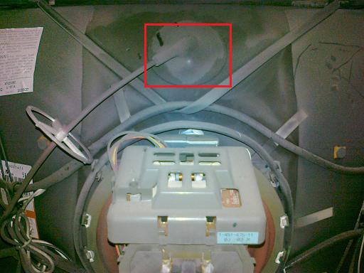

I have a Sony TV that is working perfectly (picture and audio wise).
However, today it started making a hissing noise. The noise seems to come from somewhere near the HV cable.
The weather was very humid so I suppose this could be linked to the problem (i have 2 other sets that were not affected).
What should I do? Tried using a hair dryer but nothing :(
I attached a picture to give you an idea of the situation.
Thanks :)

Electrical contact going bad? I'm not one for TV repair so I wouldn't trust my judgment but the only thing I can think of is to discharge all the HV portions disconnect the HV cable clean it up really nice and put it back on. There are some TV guys here though hopefully they'll chime in.
I cleaned around the cable and the noise was reduced. :D
I didn't want to snatch the cable as I was afraid of breaking something.
Now I closed it up, maybe tomorrow, if the noise persists I'll do a proper clean-up.
before you do ANYTHING with that anode cap.... with the unit unplugged from the wall, take a long skinny screwdriver, and clip an alligator clip wire to it near the handle. clip the other end of the wire to a chassis ground in the TV or to a metal braid that goes across the grey coating on the outside of the tube. slide the blade of the screwdriver up under the anode cap until it makes contact with the contact button on the tube. you may hear a pop. keep the screwdriver blade in contact with the anode button for a few seconds (count to 10). this discharges the capacitor formed by the outer coating and inner coating of the tube. you can now safely remove the anode cap. the anode cap connection is two metal fingers in the rubber cap. bend the rubber up so you can see them. push the cap to the side until one of the fingers releases from the recess in the tube and remove the cap. clean the rubber cap and the surface of the tube with 99% alcohol and let dey. coat the area around the button on the tube with silicone grease, and the matching surface of the rubber cap. bend the rubber cap backwards so you can manipulate the metal fingers back into the anode button. once they have a good grip inside the button let the rubber cap go and it should make a good airtight seal around the anode button.

It'd probably be a good idea to nip it in the bud now if you can trennonix, if that's electrical arcing the noise you're hearing is gradual vaporization of the wire contact, not something you want to allow to occur, as long as you follow a few simple precaution that Jed mentioned it's quiet safe.
most likely it's humidity causing the arcing. clean and grease the cap anyway. after you clean it inspect it for any carbon tracks (looks like jagged black lines across the mating surface of the rubber cup, or rarely, straight black lines). if that's the case, the rubber cap is beginning to break down and, although you can clean the carbon out and restore the insulating properties of the cup, if it's beginning to break down it should be replaced. arcing, heat, and corona discharge cause the rubber to de-polymerize along the track, and although you may get all of the carbon out, the rubber in the immediate vicinity of the track has partially decomposed, and may be likely to form more carbon tracks in the future. silicone rubber in this condition will be crumbly, and may be brownish or a lighter grey than the rubber around it.. silicone rubber is a very good insulator with excellent high temperature stability, but it has it's limits...
