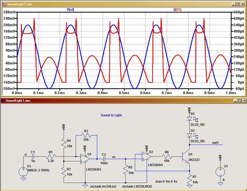

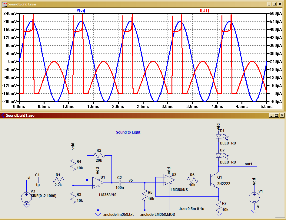

These are images of simulations using the circuit you posted, I would not call it working perfectly, there is less than 1mA in the LED's.
One image is for 1kHz and the other 5kHz.
What do you plan to do with signal into the PIC.?

Instructables are designed by people who know nothing about electronics.
The opamps are backwards:
1) The preamp opamp should be non-inverting so it does not load down the signal from the mic.
2) The LED driver opamp should be inverting so its input never goes negative.
Other problems:
3) The battery needs a supply bypass capacitor.
4) R1 should be fed from an RC filter.
5) A capacitor to ground should be at the junction of R2 and R4.

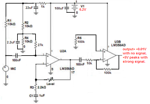

You are using two LM358 dual opamps. One LM358 has two opamps inside so only one is needed for this circuit.
The LM358 is very old and was designed for low supply current so it is very noisy (hiss). Also its high frequency response runs into trouble above only 2kHz.There are many much better low noise wide bandwidth audio opamps available.
I corrected your circuit:
I made the first opamp non-inverting with a fairly high input resistance and added one resistor.
I made the second opamp inverting.
I added important filter capacitors and one resistor.
