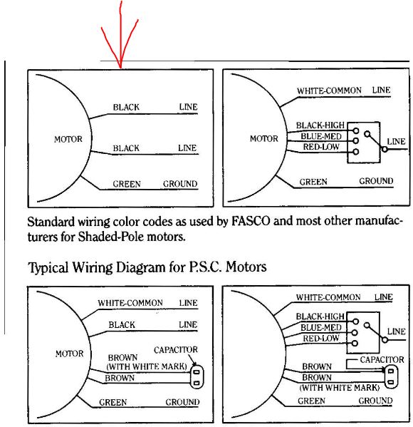

I have a Flo-Master xp2 by Aqua-flo manufactured by EME Spa Italy
Nearest I have found to the right model is this
I am fixing a pump that the wiring has been messed up and need a circuit diagram
It has a 4 pin plug (3 pins plus an earth) coming into it ,one black common and a wire to each low and high speed windings with a capacitor on each winding . There is a small relay to connect in the small capacitor it seems
It says low is 1.8A Cos .95 1420 revs 16uF Cap
It says high is10.3A Cos .97 2800 revs 45uF Cap (Huge change in Current?)
MDP 93556595
K1453A82A6100
Can anyone help with a schematic or generic type schematic Please?

Here are some generic wiring examples. The one I "arrowed" is for a standard two power winding type (what you have I suspect).
Correct on the cap sizing differences.
If you can, check the resistance of the two windings (with the common green [actually green should be safety ground]. Is there a white wire?). The higher resistance winding will be the high speed connection (and using the 45μF cap).
Resistance was about 25 ohms on the high and 22 or so on the low
The wires going into the plug from the spa controller are a green to earth, a white common , a red to high speed and a black to low

As you have observed, black is low speed and red is high speed. Two seperate windings, but with a common opposite lead. Once hooked up, should black not be low speed, the effect will be obvious. Simply swap black for red.
On that note, observe capacitor selection as chosing the wrong one for the application will, eventually, destroy it.
And, no, phase would be the same in both, just one at a time (since there's not but one phase to begin with).
