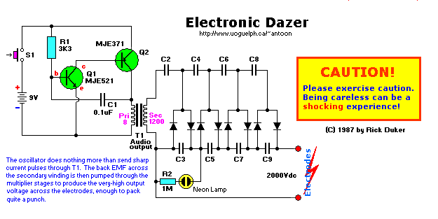

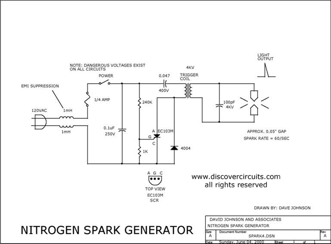

Consider some of these:

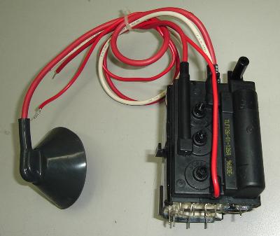

Hey Ali,
I think I am misunderstood of your goal now?!
Are you trying to make a PLASMA ARC speaker? If not, so please let us know what you desire to do exactly ?
anyhow you can use a TV or a monitor flyback transformer to generate a nice arc. today most of them have a built-in Tripler or casked which multiples the high voltage by factor of 3. The built-in Tripler reduces the size of the flyback too.
You can see a typical picture for one.
P.s. you have to know that The sharpness and the audibility of the arc is proportional to the frequency of the system.
