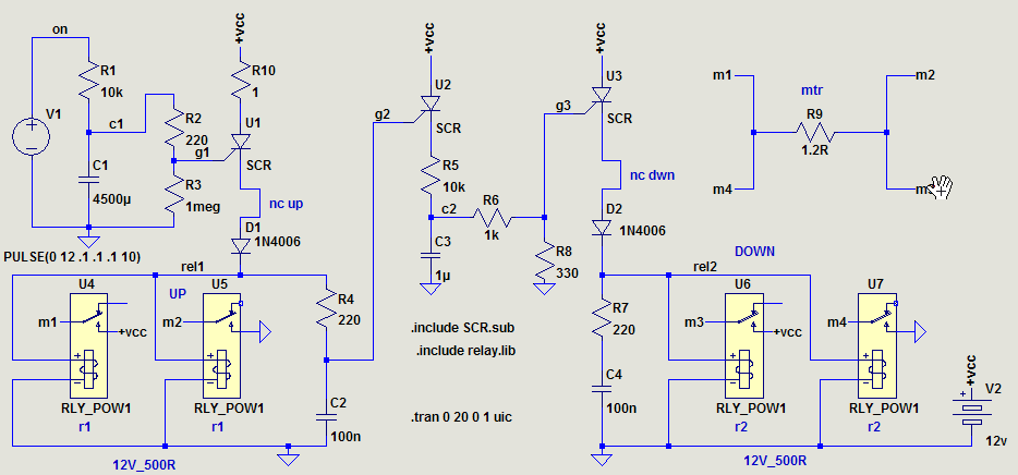

I am working on a project to build a motorized actuator for a pop-up target system similar to what the military uses, accept this would be for 3D archery. It has been a long time since I worked with electronics on the component level. I designed a control circuit for basic automated operation of of the motor but I don't know if it will work or what value my components should be. can anyone give me some assistance on this? see the attachment for details.

This is your circuit in LTspice simulation, as expected it will not work.
You should check to make sure I have not misread your sketch.

I am open to building from your drawing. I am able to do board and component work ok. Like I said before its been a long time since I took electronics in college and I never did much in the way of design work. I am curious as to why my design wouldn't work, I tried to build it last night on a practice board but it didn't work (no surprise since I really didn't know what value components to use).

Study the effect on the voltage across the 1st SCR when switched to conduct.
All the voltage appears across Rel1, so the SCR switches OFF.
Also consider the value of the timing caps that trigger the SCR's gates, the Gates require a current drive over a certain value in order to set the SCR on.
etc....

In its present configuration, IMHO the circuit is not workable.:)

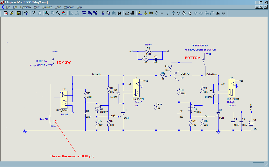

hi TK,
Look at this provisional design.
I would have preferred SPCO relays contacts, so that it could be wired to prevent misoperation of both relay sets at the same time.
Some extra circuitry is required if you require safety interlocks.

Hi; just had a look at the schematic. looks good to me, but it looks like you are using a pulsed voltage to make it work. is that right or am I just getting confused by the current diagram. my power source is the 12 volt battery, would I need a separate power supply for triggering this circuit? also, I want to be able to trigger it by remote up to 40 meters away. I was looking at some commercial stuff, but I would like to build something that is more specific to what I am doing. Any suggestions? P.S. I can probably get the SPCO relays without any problems, I don't have to use these relays. Having interlocking relays is a good idea as I wouldn't want to create a glitch that could mess up my system (or launch my 3D target at an unsuspecting archer. lol)
Its only pulsed for the simulation.
A standard n/o toggle switch will start the sequence.

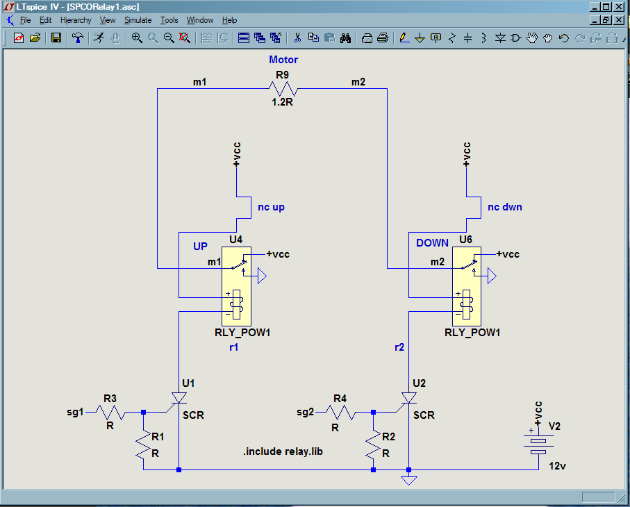

Look at this option for SPCO relays.:)

Thank you for this information. I can't believe I didn't think of using that type of relay. I guess I had my mind locked on the other type of relay. I am going to get the components and build this controller. I will let you know how it works out.

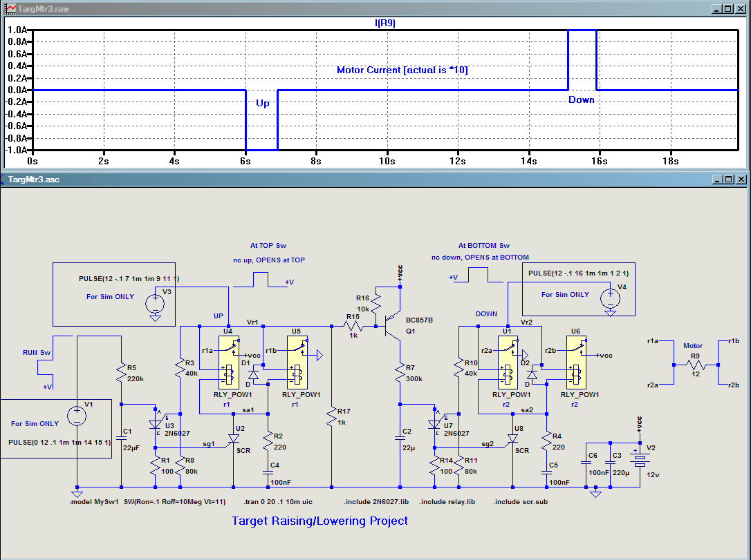

OK, so I will post the circuit showing these relays.
Ive added a simple relay to the circuit, this will act as a latch when you push the remote switch [ 40mtrs] away.
EDIT:
I have deleted the refs to the sim, should make it easier to follow.:)

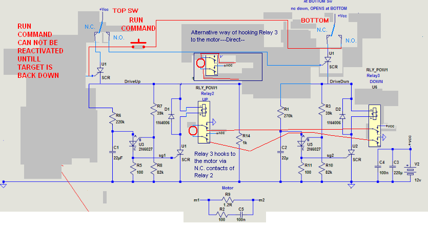

May I suggest a few slight modifications, attached, and ask a question of Eric?
In the bottom left of your drawing, why parallel a 100nf with a 220uf? My logic says the 100nf is like another handful of sand in a child's sand box, you'll never notice the change. Is there a specific reason for it?

hi,:)
If you compare the capacitive reactance of a 100nf[ ceramic] with a 220uF electrolytic cap, you will see that the 100nF has a much lower reactance value at higher frequencies than a electrolytic.
So it is more effective in reducing the higher freq noise.
Its common practice.
BTW: in the drawing you modified, the OP didnt have SPCO relays, I had to use that symbol.
Thank You, I suspected that frequencies might be the reason, although I didn't know the reasoning behind it. I also modified my drawing some more and replaced what I had.
Appreciative,
Kinarfi
Hi; it took me a few minutes to digest the information change but I have it now. You have 2 SCRs that drive the relays but they aren't labeled for a particular type, I assume I can use the SCRs that I have already? also do you have any suggestions for a simple wireless remote to use to trigger the unit?
