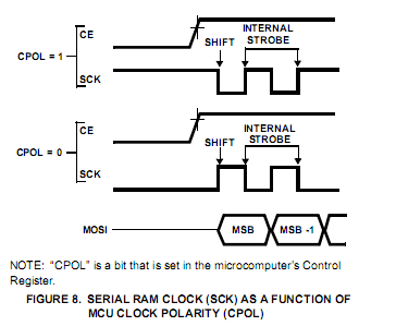

So how do you explain that in CPHA=CPOL=1, we firstly transmit the data (falling edge) and only then sample the data (rising edge)?
hi RF,
This is a clip showing the 'shift' and 'strobe' for SPI.
E
The sampling of the data isn't in our control!!! The SPI module just sends..... The reception is another thing.
When we want to get a byte from an external device we send a byte to it so we can get a byte back...
The SD0 line doesn't need to be bothered with...
Are you making a software SPI routine? I can't think why you need to worry about the transmitting / receiving part..

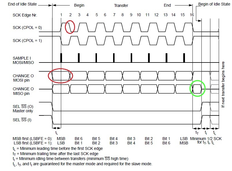

Ian,
I deeply thank you for your support.
I'm trying to understand how SPI works, and not just how to code it, which is more simpler.
I read in Wiki that:
Wikipedia said:
Note that with CPHA=0, the data must be stable for a half cycle before the first clock cycle. For all CPOL and CPHA modes, the initial clock value must be stable before the chip select line goes active.
That makes a lot of sense - I think I got that part :)
Thank you Ian for your awesome support :)
Could you please explain what is that trailing bit circled with GREEN?
