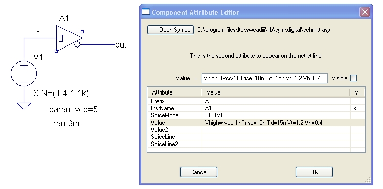

Len, if you want it for SwCAD, I can show you how to set up the Schmitt trigger that's in the digital library to do a fair emulation of a 74LS14. Or you might figure it out for yourself. :D
ljcox said:
Ron,
I looked at it but could not see how to do it. So please advise.

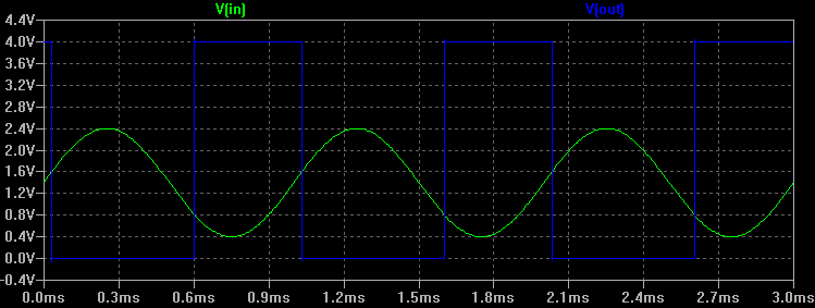

OK, place a Schmitt trigger on the schematic and right-click on it. Below is a screen capture of this. I parameterized the logic high voltage as an example. You could just make it 4, or 5, or whatever you think is right. I also picked typical values for delay, rise time, threshold voltage, and hysteresis. You can get them from the datasheet. If you want to add input and output resistance and capacitance, you will have to add them externally.
This model is only behavioral, but is still very useful, and runs very fast.
You can, of course, do similar setups with any of the digital parts. The D FF is very useful. I made a model of a 4-bit counter using these models,and it matched the CMOS part (can't remember which one, and I think it's on my computer at work) pretty well.

1. I inserted your model, but I can't see how to specify Vcc - see the screen dump below.
Notice in the screen capture above: ".param vcc=5". To place that on the schematic, click on the .op icon at the right end of the toolbar and type it in, then click OK. You need this tool for several options in SWCAD. I'm assuming you already know how to use it to add a component to the schematic that was not in the original library.
2. I read the help about mutual inductance, it said to use this format:- K1 L1 L2 1 but can't see how to input this data. I assume that L1 and L2 are drawn in the normal way and then the Mutual Inductance parameters are input to connect them.
Please help.
This is also done using .op. Type in "K1 L1 L2 0.999" (or whatever value you choose) and click OK.
